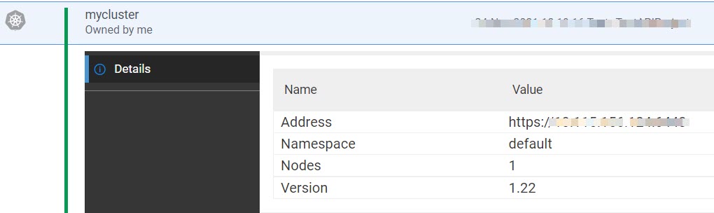

Note: You can add the clusters that are registered with the team space. You can add any number of clusters to your project.The clusters that you added to the project are displayed.You can view the details of the cluster by clicking the Expand icon
.The following table describes the details about the cluster:
Name Description Address Specifies the address of the remote Kubernetes API. Namespace Specifies the namespace of the remote Kubernetes cluster in which the test runs occur. Nodes Specifies the number of nodes in the remote Kubernetes cluster. Version Specifies the Kubernetes version of the remote Kubernetes cluster.
