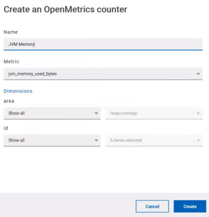

- Click the checkboxes to select counters in the Select OpenMetrics counters dialog box.
Follow these steps to create a counter:
Follow these steps to duplicate a counter:
Select a counter in the list, and click the
Duplicate icon
- Modify the name of the counter and the Dimensions.
- Click Create.

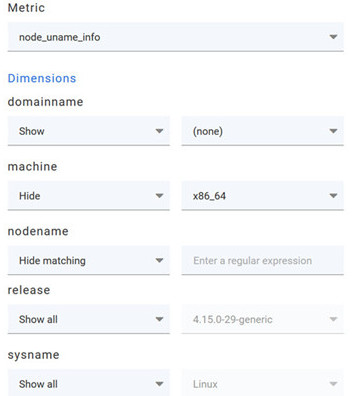

Proceed as follows to modify a new counter:
- Click the Modify icon.
- Modify the name, Metrics, and Dimensions of the counter in the Modify the OpenMetrics counter.
- Click Update.
