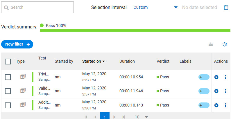

Test results list
When you expand the results, the results details and reports cards are displayed.
Results, reports, and logs are generated for tests run from HCL OneTest™ Server, or from desktop clients such as HCL OneTest™ Performance, HCL OneTest™ UI, or HCL OneTest™ API.

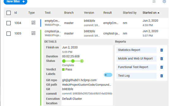

Test result details
By using the default settings, you can view the following details about the test assets used in the test run in the Details card:
- The status of the test results, the date and time it was executed and completed.
- The details about the Git repository that contains the test assets.
- The execution location that uses the test asset for a test run. Note: The execution location can be the default cluster or the location that you indicate to override a docker host or the agent location when you execute a test. For more information about test configuration, see the link at the end of this page.
- The Resource Monitoring labels (override) used in a performance schedule to control Resource Monitoring sources. For more information about controlling Resource Monitoring sources, see the link at the end of this page.
You can configure the information displayed in the Details card
and the Results columns from the View
Settings window. You access this window by clicking the
Settings icon
Depending on the attribute you cleared in the View Settings window, the Details card displays additional information about the test results.
The selected attributes are displayed in columns of the Result view.
Reports
The Reports card contains the links to the test reports and the logs that are displayed in a web browser.
