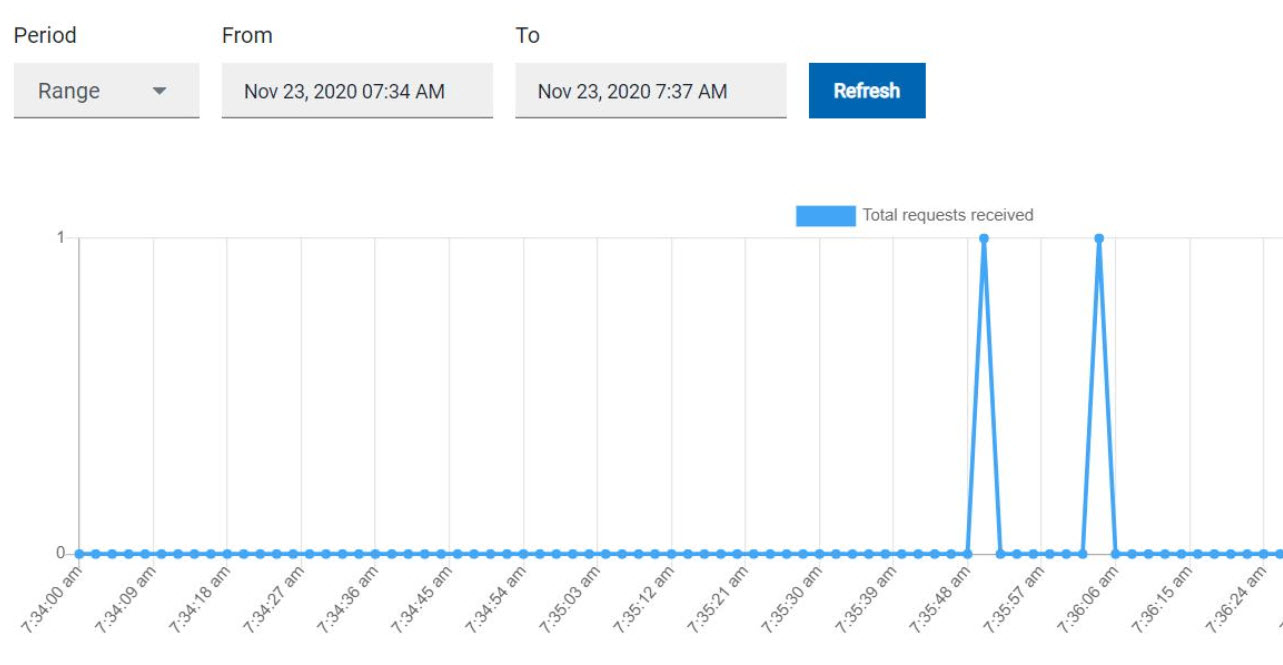

The stub details are displayed as a graph. The default view displays the stub usage data that is gathered during the previous week and grouped in an hourly interval. The total requests received from when the stub was started are displayed.
The metric data that is reported is for the number of requests that are received by a stub. These can be requests, messages, or other calls that are received by the stub.
You can change the default view by selecting an option from the following options:Option Description 1 Week Displays the stub usage data that is gathered during the previous week and grouped in an hourly interval. Note: This is the default view.1 Day Displays the stub usage data that is gathered during the previous day and grouped in an eight-minute interval. 1 Hour Displays the stub usage data that is gathered during the previous hour and grouped in a 20-second interval. Range Displays the stub usage data that is gathered during the date range specified in the From and To fields. You can select the date and time for both the From and To fields. The data is dynamically grouped in intervals that depend on the range selected. Note: You can refresh the view at any time to present the graph for the latest data by clicking Refresh. -

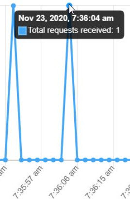

View details of the stub by hovering the mouse over any of the data-points to
view the stub details at that point.
The following details about the stub are displayed when you hover the mouse over the data-point:
- Date and time of the request received.
- Number of requests received.
