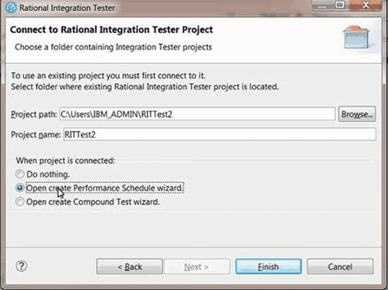

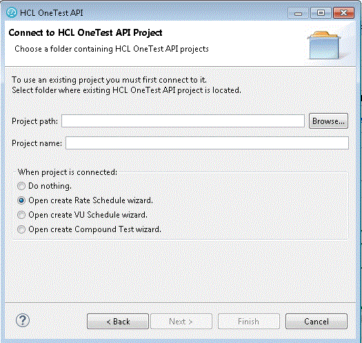

Connecting to an existing API project
- In HCL OneTest™ Performance, right-click on
the Test Navigator, select and click Next.
- In the wizard page, click Browse and select the root folder that contains
the project.
If the path contains a project, its name should automatically appear in Project Name and the Finish button should be enabled.
- In When project is connected, you have to perform one of the following
actions:
- Click Do nothing to only import the project.
- Click Open Create Rate Schedule wizard to select the test, create a Rate Schedule, and add the test to it.
- Click Open Create VU Schedule wizard to select the test, create a VU Schedule, and add the test to it.
- Click Open Create Compound Test Wizard to select the test, create a
Compound test, and add the test to the Compound test. For more details, see Creating a compound test and Adding tests into a compound test.
For example: select the Open Create VU Schedule wizard action and click Next.
The Create Rate Schedule for Integration Tester or Create VU Schedule for HCL OneTest API wizard displays the list of tests contained in your project.
- Select one or more tests and click Next.
- In Schedule File Name and Location wizard, select a schedule in an existing project, or create it from this window. You just need to enter a name for the new schedule and click Finish. The procedure is the same for the compound test.

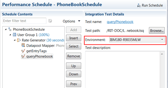

Modifying HCL OneTest™ API environments in HCL OneTest™ Performance
In the schedule or compound test, you can select HCL OneTest™ API tests and change the environment of each test. The environments are set in HCL OneTest™ API, you can only change the selection from the edited schedule or compound test.
- Open the schedule or compound editor and select a test.
- In the HCL OneTest™ API details, you can browse and
change the properties of the selected test. The Test path, the
Environments and Decription are
automatically updated accordingly.
- To select another environment for the Integration Tester test, use the dropdown menu.
Alternatively, you can change the environment selection for a test for a collection of tests:
- Right-click on the tree at any level under a node in the schedule or compound test and select Replace HCL OneTest API Environments.
- In the Set Invocation Tester Environments wizard, the first page displays
the list of projects that use the selected environment and the number of tests from
project that use this environment in the schedule or compound test.
- Select another used environment in the dropdown list. Click Finish. The new choice applies to the selected node and its children.
