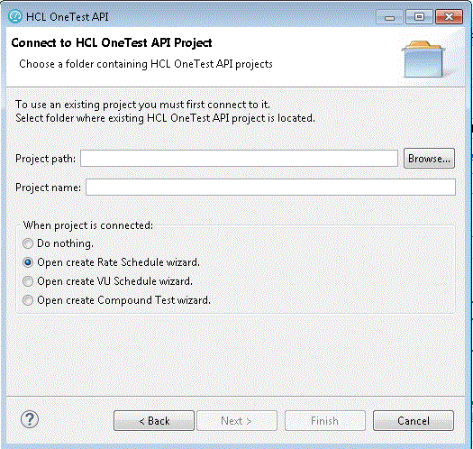

- In HCL OneTest™ Performance, right-click on
the Test Navigator, select HCL OneTest™ API and click Next.

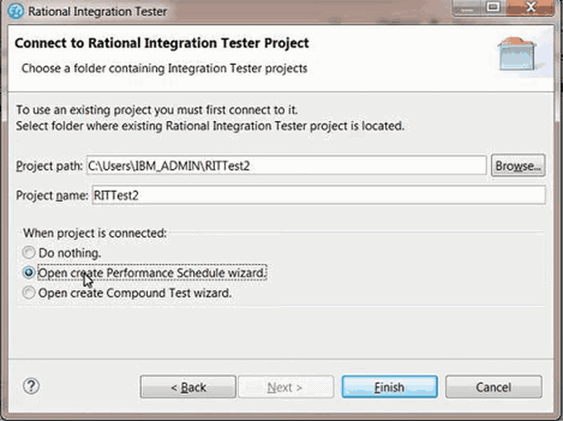

- In the wizard page, click Browse and select the root folder that contains
the project.
If the path contains a project, its name should automatically appear in Project Name and the Finish button should be enabled.
- In When project is connected, you have to perform one of the following
actions:
- Click Do nothing to only import the project.
- Click Open Create Rate Schedule wizard to select the test, create a Rate Schedule, and add the test to it.
- Click Open Create VU Schedule wizard to select the test, create a VU Schedule, and add the test to it.
- Click Open Create Compound Test Wizard to select the test, create a
Compound test, and add the test to the Compound test. For more details, see Creating a compound test and Adding tests into a compound test.
For example: select the Open Create VU Schedule wizard action and click Next.
The Create Rate Schedule for Integration Tester or Create VU Schedule for HCL OneTest™ API wizard displays the list of tests contained in your project.
- Select one or more tests and click Next.
- In Schedule File Name and Location wizard, select a schedule in an existing project, or create it from this window. You just need to enter a name for the new schedule and click Finish. The procedure is the same for the compound test.

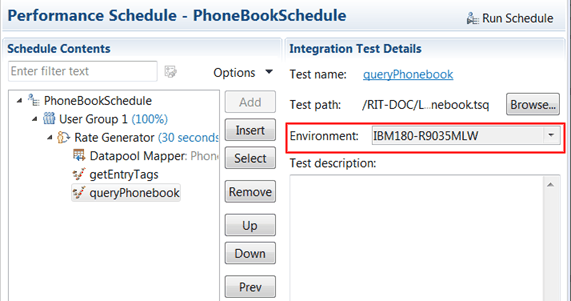

In the schedule or compound test, you can select HCL OneTest™ API tests and change the environment of each test. The environments are set in HCL OneTest™ API, you can only change the selection from the edited schedule or compound test.
- Open the schedule or compound editor and select a test.
- In the HCL OneTest™ API details, you can browse and change the properties of the selected test. The
Test path, the Environments and
Decription are automatically updated accordingly.
- To select another environment for the Integration Tester test, use the dropdown menu.
