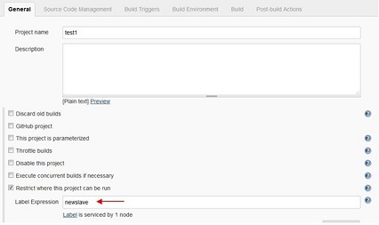

While creating the job configuration, in addition to the preceding steps, you must select the Restrict where this project can be run check box and provide the name of the slave node in the Label Expression field. This is the location where the products are installed and where tests can be run.
