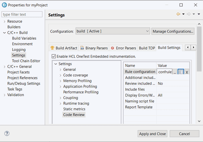

- In the project explorer, right-click the project on which you want to change the settings and click Properties.
- Expand C/C++ Build in the left panel, select Settings.
- In the right panel, in the Build tab, expand Settings and select Code Review.
Expand Code review to access the code review settings.
Click in the value on the Rule configuration row and click
... to select a rule configuration file.
Note: If your configuration file is an out-of-date version, you are prompted to update it. Click ok to select the rules that are missing in your configuration file. The selected rules are added with their default severity levels to your configuration file. Unselected rules are added to your configuration file as disabled rules.
- Select the default MISRA 2004 or MISRA 2012 rule configuration file that are installed with the product. Alternatively, click + to select a new rule configuration in your browser.
Click OK.
The path to the selected rule configuration is displayed in the value column on the Rule Configuration line.

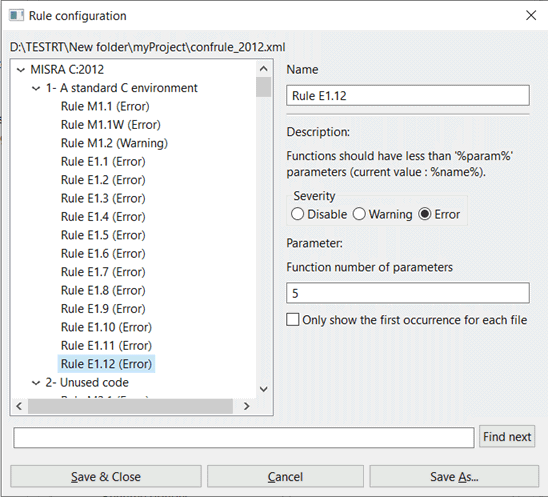

On the Rule configuration row, click the
to open the Rule Configuration window.
In the Rule configuration window, select the rule that you want to
configure.
Rules are grouped into categories. You can filter the rules by labels from the Find field. Search is not case sensitive.When a rule is selected, its description is displayed on the right panel with the parameter description and value if any parameter is available for the selected rule.
On the right panel, select the severity level:
Select Show only the first occurrence to only show the first
occurrence of a rule condition in a file. Any subsequent occurrences of the condition are not
reported.
