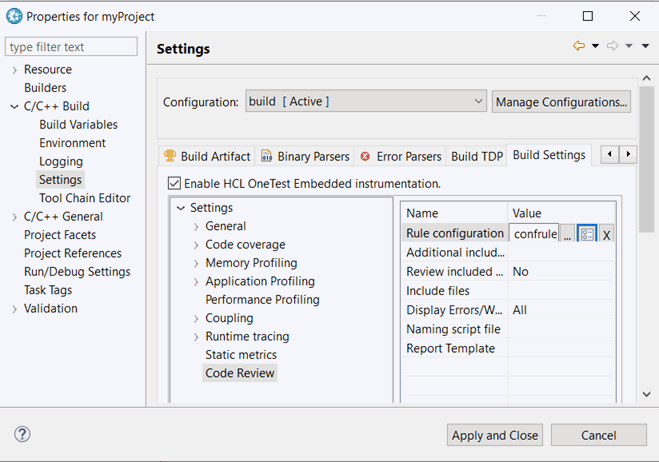

To select the configuration file and disable or set the severity level of code
review rules:
- In the project explorer, right-click the project on which you want to change the settings and click Properties.
- Expand C/C++ Build in the left panel, select Settings.
- In the right panel, in the Build tab, expand Settings and select Code Review.
Expand Code review to access the code review settings.
- Click in the value on the Rule configuration row and click ... to select a rule configuration file.
- Select the default MISRA 2004 or MISRA 2012 rule configuration file that are installed with the product. Alternatively, click + to select a new rule configuration in your browser.
Click OK.
The path to the selected rule configuration displays in the value column on the Rule Configuration line.

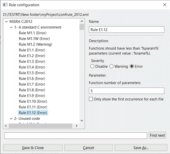

On the Rule configuration row, click the
to open the Rule Configuration window.
In the Rule configuration window, select the rule that you want to
configure.
Rules are grouped into categories. You can filter the rules by labels from the Find field. Search is not case sensitive.When a rule is selected, its description is displayed on the right panel with the parameter description and value if any parameter is available for the selected rule.
On the right panel, select the severity level:
- Disabled: The selected rule is ignored and is not displayed in the code review report.
- Warning: When the rule condition is found, a warning is displayed in the code review report.
- Error: When the rule condition is found, an error is displayed in the code review report.
Select Show only the first occurrence to only show the first
occurrence of a rule condition in a file. Any subsequent occurrences of the condition are not
reported.

To configure the Multi_thread option, follow these steps:
- In the Project Explorer, right-click the project on which you want to change the settings and click Properties.
- Click and select Build Settings.
- In the right panel, click General > Multi-Thread option.
- Click ... in the value field of the Entry points option to open the editor.
- In the editor, enter the list of entry points for each thread and click OK.
Click OK, Apply the changes and close the
Properties window.
Note: The Entry point option applies to rule E16.50 (MISRA_2004) and M2.2.2 (MISRA 2012).
