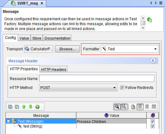

A blank message is displayed.
Set the Formatter field to Text.

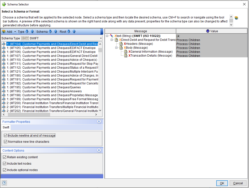

The Schema Selector dialog box is displayed.
Click the Schema Type field in the Schema Selector dialog box, and then select .
The SWFT schemas that you can apply to the message are displayed.
Select a SWIFT schema from the list in any of the following methods:

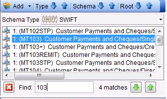

- Select one of the displayed roots.
- Press Ctrl+F.
A search field is displayed.
- Type the number or other identifiers for the root.
For example, you can enter 103 or 103STP to find entries that have the matching number or text in them. The identifiers you enter need not be complete. From the matching entries, you can use the arrow icons to scroll up or down the list to find the item you are looking for in the list.
Expand the Formatter Properties section and perform the action listed in the following table:
Option Description Action Include newline at the end of message
The Include newline at the end of message check box can be either selected or cleared based on the default action set in .
When a Swift message is sent, some systems expect the formatting of the last block to include or omit a trailing new line. By using the Include newline at the end of message check box, you can control the appending behavior of the newline character in the schema message.
When this check box is selected, a newline character is appended in the SWIFT message.
When this check box is not selected, a newline character is not appended in the SWIFT message.
Retain the selection or clear the selection.
Normalise new line characters
The Normalise new line characters check box can be either selected or cleared based on the default action set in .
By using the Normalise new line characters check box, you can control the CRLF end of line character normalization behavior in the Swift message.
When this check box is selected, all Swift message LF characters are normalized to CRLF characters.
When this check box is not selected, all Swift message LF characters are not normalized to CRLF characters.
Expand the Content Options section and select your action from the following options.
You can use the SWIFT options for the content in the messages that are used in the tests. The content depends on the SWIFT schema that you select for the messages.
Note: The check box for the options to Retain existing content, Include Text nodes, or Include optional nodes can be either selected or cleared based on the default action set in .Option
Description
Action
When this option is selected, you can apply a schema or expand a field without losing the original data in the messages.
When this option is not selected, existing data is cleared before the new schema is applied.
In cases where the data is assumed to be retained, this option is not displayed.
Include Text nodes
When this option is selected, you can generate Text nodes with the message.
When this option is not selected, the text nodes do not appear.
When this option is selected, you can select and add the optional fields that the schema includes in the message.
When this option is not selected, you cannot add any optional fields.
Click OK to save your settings and close the Schema Selector dialog box.
The completed message is displayed.
