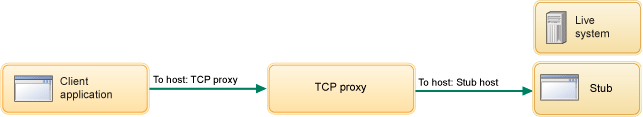

- The simplest method is to configure the
HCL OneTest HTTP/TCP Proxy, as a reverse TCP proxy (see Proxy server changes the destination host to the live server and Proxy server changes the destination host to the stub). Change the host name and port of the endpoint
that is used by the system under test, such that the system sends traffic to the host and the port
that is specified in the bind attribute of the forwarding rule for the proxy. When the stub is
running, the messages are dynamically routed to the stub. When the stub is not running, the messages
are sent to the live system, if available.
See Configuring a HTTP(S) reverse proxy or TCP port forwarding.Proxy server changes the destination host to the live server shows the system under test addressing a message to the host system where the proxy server is running. In the absence of a running stub, the proxy server then re-addresses the message to the live system, as specified in the bind attribute of the forwarding rule for the proxy.
Figure 2. Proxy server changes the destination host to the live server
Note: Many TCP applications make a single permanent connection to the live system and send multiple messages across it. Ensure that your stub is started before the application connects to the TCP proxy. Failure to do so will result in the application making a connection to the live system and the stub will not be used.Proxy server changes the destination host to the stub again shows the system under test sending a message to the proxy host. This time a stub is running, so the proxy server reroutes the message to the stub, based on the rule that the stub created on the proxy. You can see those rules on the Network Dashboard in HCL Quality Server. For more information, see Viewing running agents.Figure 3. Proxy server changes the destination host to the stub

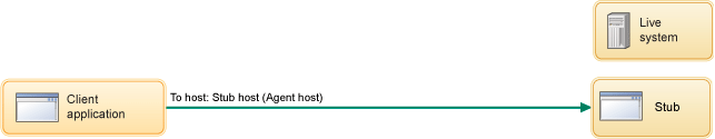

- Another alternative is to configure the system under test to connect
directly to the stub (see Direct connection
to stub). This process
requires assigning a fixed port number to the transport that the stub
uses. To do so, go the Physical view of the HCL OneTest™ API Architecture
School perspective, right-click the TCP server resource, and click Open
physical resource. On the Server page, Socket
Overrides section, enter a number for the Port field
that does not conflict with anything on the host where the stub will
run. That host is one of the following servers:
- The server where HCL OneTest™ API is running
- If running through HCL Quality Server, the server where the HCL OneTest™ API Agent is running
For more information about socket overrides, see Creating physical TCP servers.
Next, configure the system under test to use as its endpoint the host and port number of the server where the stub will run, rather than using the host and port for the live system. Be aware of the following limitations:- This method does not route messages dynamically. When the stub is not running, connections fail.
- All traffic for the specified endpoint is routed to the stub. This method does not filter the traffic based on operations.
- With other methods, you can have multiple Agents and the stub can run on any Agent that is registered with HCL Quality Server for the correct environment. With this method, if you use HCL Quality Server, you must configure the system under test to use the exact machine on which the Agent runs the stub.
Direct connection to stub shows a direct connection from the system under test to the system that hosts the stub. No messages go to the live system; they are all addressed and sent directly to the stub. To filter the messages, use the proxy server described earlier.Figure 4. Direct connection to stub

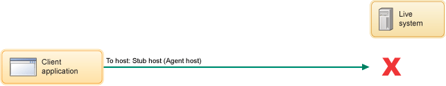

Direct connection to stub that is not running shows that the connection fails if the stub is not running, because the client connects directly to the port where it expects the stub to be running. To avoid this problem, use the proxy server described earlier.Figure 5. Direct connection to stub that is not running
