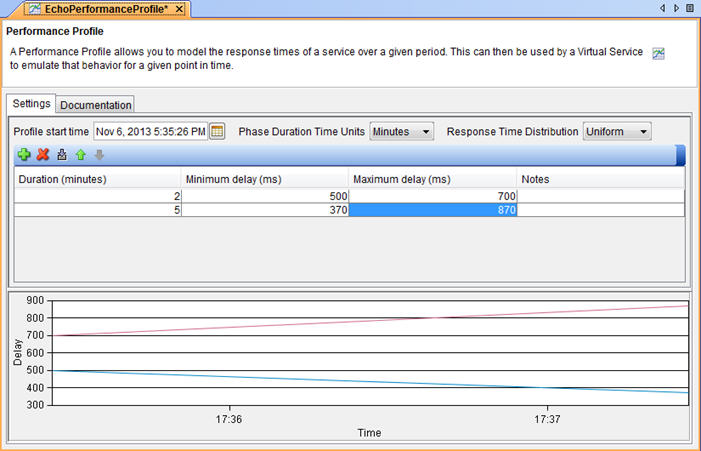

- To create a phase, click the Plus sign icon (+). A row is
displayed with cells where you can enter values for each setting. As you add phases and data, a
graph that represents the performance profile displays:
To alter displayed values, you can either change the values in the table, or drag data points in the graph vertically. If you drag the data points in the graph, the values in the table change to reflect the new data points. - To change the order of phases, select a row and then use the up and down arrows at the top of the Settings tab. To delete a phase, select the row and click the Delete (X) icon.
