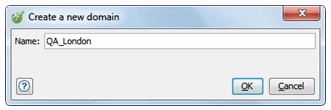

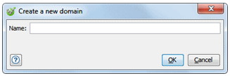

The Create a new domain dialog box is displayed.
- In the Name field, enter the name
of the new domain.
- Click OK.
The Create a new domain dialog box is closed and the new domain is selected in the Domain list.
