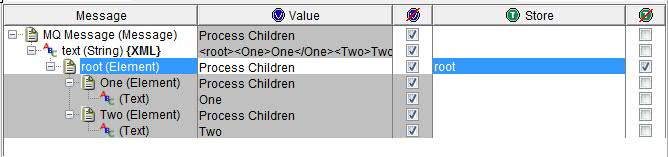

The tag is a plain string type. | To display the tag value, you should use a Log
action before the message action. It should display {} characters
as shown: root={one={="one"} two={="two"}}. See
the image for guidance: ![]() |
