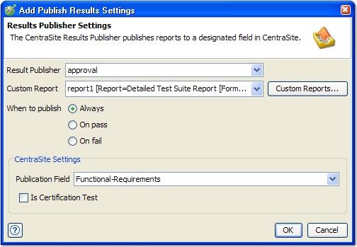

Click Add to add
a publisher to the suite.
The Add Publish Results Settings dialog is displayed.
- Select the wanted CentraSite publisher from the Result Publisher box.
- Select the report to include from the Custom Report box (For more information, see HCL OneTest API reference
- Select the wanted option for when the report is published (always, on pass, or on fail).
- Under the CentraSite Settings, select the wanted publication field for the report from the Publication Field box (see Managing CentraSite publication fields for more information).
If the current suite is the certification
suite for the selected asset, enable the Is Certification
Test option (for more information, see Certification test suites for CentraSite.
