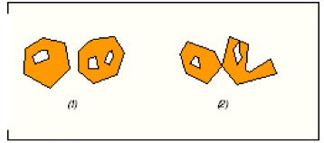

The following figure shows examples of ST_MultiPolygon:
(1) is ST_MultiPolygon with two ST_Polygon elements. The boundary
is defined by the two exterior rings and the three interior rings;
(2) is an ST_MultiPolygon with two ST_Polygon elements. The boundary
is defined by the two exterior rings and the two interior rings. The
two ST_Polygon elements intersect at a tangent point. Figure 1: Examples of ST_MultiPolygon
objects
