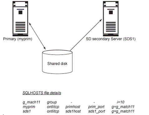

    Make sure the SQHOSTS file at both the primary and SDS node has entries for the other server:
    g_mach11  group     -         -          i=10
     myprim    ontlitcp  primhost  prim_port  g=g_mach11
     sds1      ontlitcp  sds1host  sds1_port  g=g_mach11
    Note that the use of groups here is optional. However, we include it to prepare for an example below.

    The SD secondary is now up and running! You can check the cluster status using the onstat -g sds command at both the primary and secondary servers. Here's what our cluster looks like:
    Figure 1. The cluster: Primary and one SD secondary
