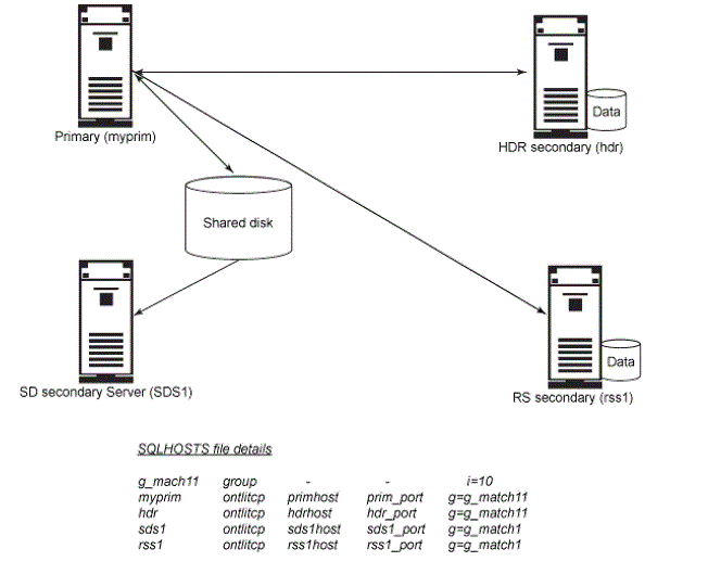

    Now RSS node is up and running! Run the onstat -g rss command to check RSS node status at both primary and RSS nodes. Now our cluster looks like this:
    Figure 1. The cluster: Primary and one SD secondary
