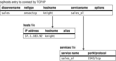

- Network communication with TCP/IP
- When you use the TCP/IP connection protocol, the
host namefield is a key to the hosts file, which provides the network address of the computer. The name that you use in thehostnamefield must correspond to the name in the hosts file. In most cases, the host name in the hosts file is the same as the name of the computer. - UNIX: Shared-memory and stream-pipe communication
- The service name field is called
servicenameon the UNIX operating system and SERVICE on the Windows operating system. When you use the TCP/IP connection protocol, the service name entry must correspond with the name in the services file. The port number in the services file tells the network software how to find the database server on the specified host. - Windows: Named-pipe communication
