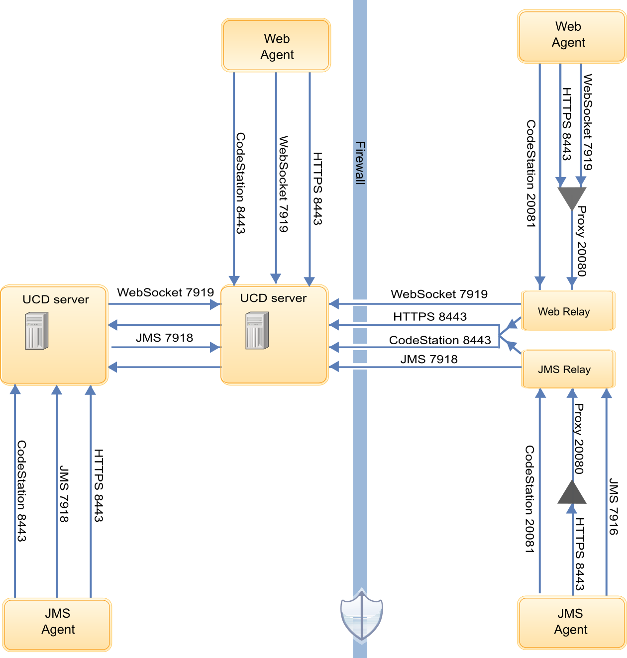

When you use web agents, each server in a cluster has a distinct URI and each server establishes a direct connection to every other server, which results in two connections between each server. The server-to-server connections advertise connected web agents to the cluster and exchange messages for them.
When a new server is added to a Web agent-enabled cluster, it connects to the previously defined servers. The other servers respond by connecting back to the new one. In normal operation, each server has two connections to each of its peers.

Agents and relays connect to one or more servers at their respective URL ports. They can be
configured to use a common URL, for example, a load balancer. However, servers must be configured
with direct URLs. The agentcomm.proxy.uri property can define a single HTTP proxy
