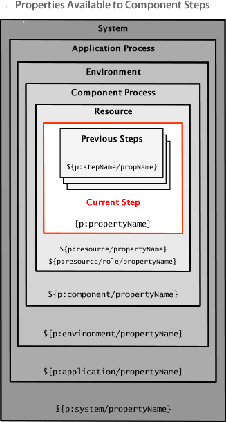

In addition to a step's own properties, a command has access to properties set earlier by other steps within the process, to properties set by the application that started the component process, to properties on the target environment and resource.
The following illustration shows the properties that are available to an individual step. Step property values become unavailable after the component process ends.
Runtime defined properties are combined with the properties that were defined earlier and together sent to the agent. Earlier properties (those properties that were defined outside the current process) are retrieved from the database. How properties are processed and consumed is discussed further in the next section.
