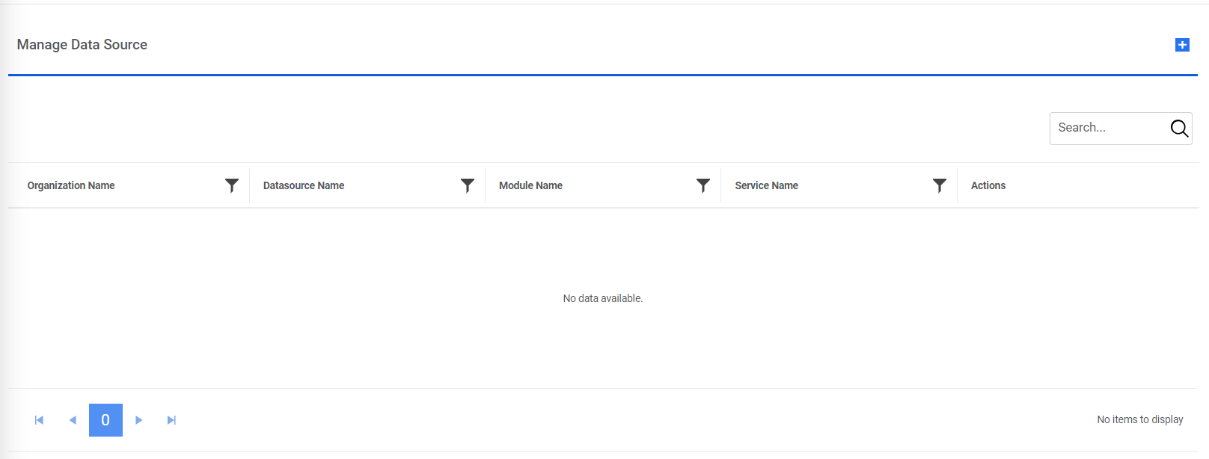

To create a data source, perform the following steps:
  1. Log in with Organization Admin user.

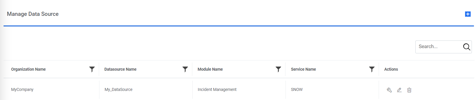

  2. On the main menu bar, click Configuration 🡪 Manage Data Sources.
  3. On the Manage Data Sources screen, click .
    Figure 1. Data Sources
  4. The Manage Data Source page appears with the following tabs:

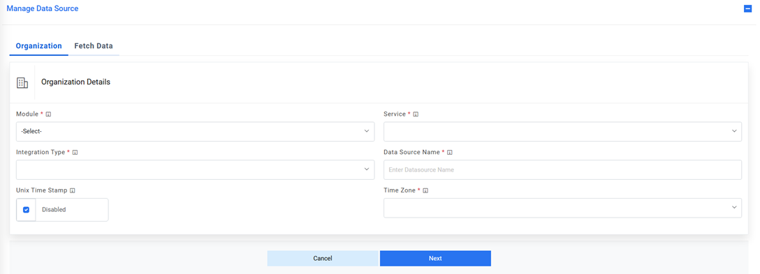

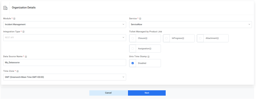

Organization Details

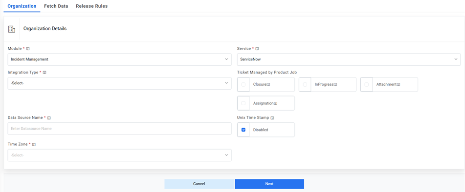

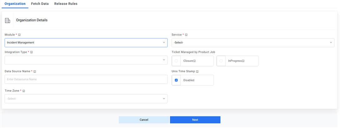

Users can set up organization details, for which the data source will be created, by performing the following steps:
  1. On the Organization tab, Select a module where the organization brings the data from the data source in BigFix Runbook AI, from the Module field.
  2. Upon selection of the Module, the following two additional input parameters will be populated. Select the appropriate option
    1. Closure: Check this option if you want product to manage the ticket closure updates instead of the RBA tool. In this scenario, an additional tab “Close Rules Configuration” will be activated for providing further details, steps for which are mentioned later.
    2. InProgress: Check this option if you want product to manage the tickets in progress status updates instead of the RBA tool. In this scenario, an additional tab “InProgress Rules Configuration” will be activated for providing further details, steps for which are mentioned later.
      Figure 3. Select Organization Details
  3. Select a service, with which BigFix Runbook AI is integrated and pulls data for automation, from the Service field. Upon selection of service, the below 2 options are populated:
    • Attachment: Check this option if you want to use the product’s API to Upload/Download attachment of ServiceNow.
    • Assignation: Check this option if user wants to use the assignation feature of the product where the configuration is done for assigning the ticket to separate user/group.
      Figure 4. Select Organization Details (Cont.)
      The attachment option is available if selected Service is servicenow. Assignation is visible if selected service is either ServiceNow or servicexchange.
      Multiple source types are available.
  4. Select the integration method to integrate between BigFix Runbook AI and the selected service type from the Integration Type field.
  5. Provide the data source name.
  6. Select the time zone in which ITSM tool API return data.
  7. Unix Time Stamp: By default, its disabled but if ITSM provides response in different time format such as UNIX then this needs to be unchecked.
  8. Click Next to update the data source details.
    Figure 5. Select Organization Details (cont.)
    All fields marked with an asterisk (*) are mandatory.

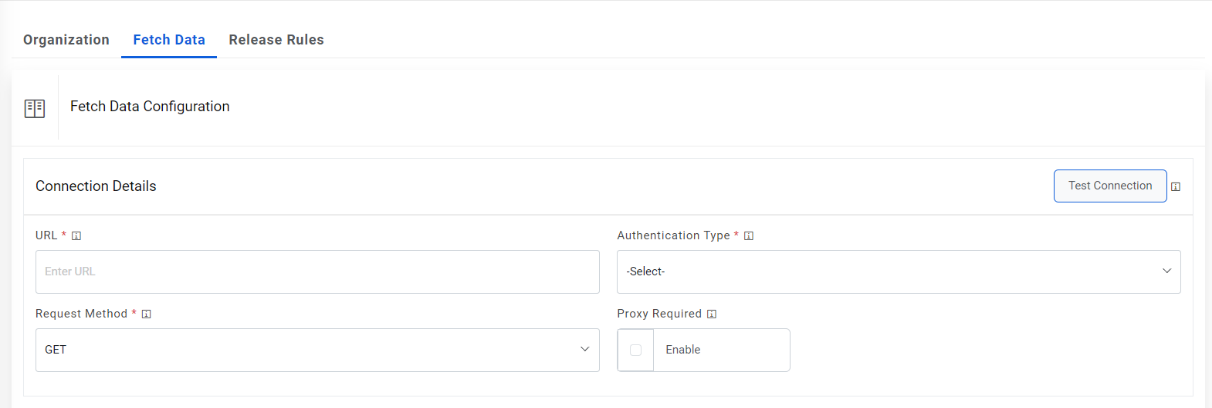

Fetch Data Configuration

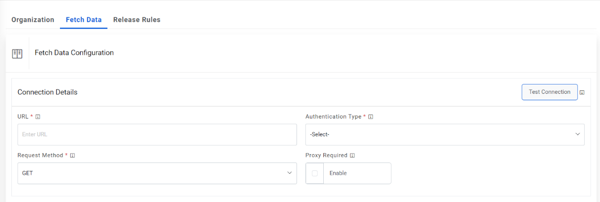

Users can configure a method for fetching data from the data source by using the following steps:
  1. On the Fetch Data Configuration page, type the URL of the selected service type in the URL field to fetch data.
  2. This URL contains the placeholders that display the parameters based on the applied clause such as the number of records to be fetched, query type, date on which the data is fetched, and the order by and so on. It depends on the URL or API provided by the tool.
    Figure 6. Fetch Data Configuration

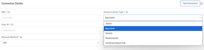

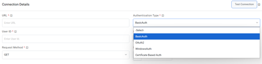

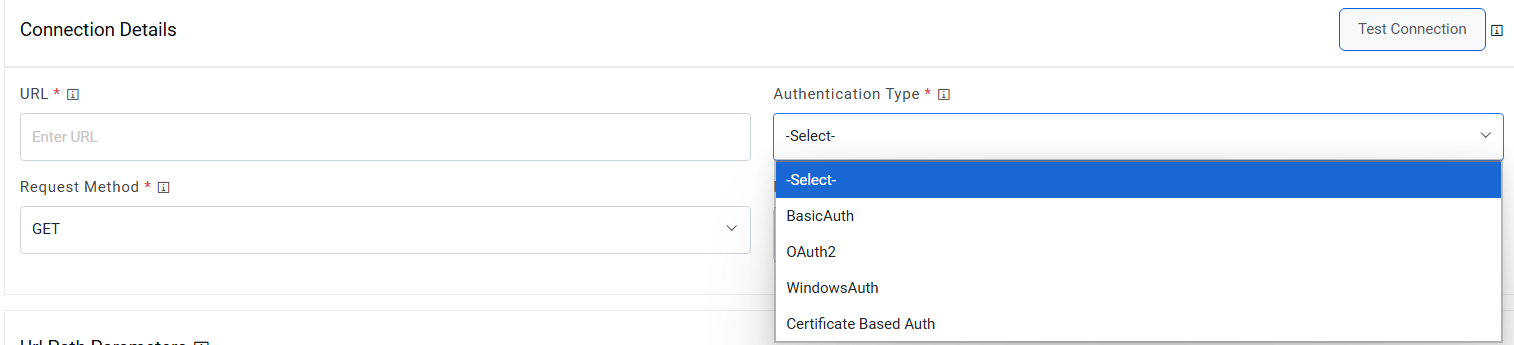

  3. Select the Authentication Type. BigFix Runbook AI supports the following types of authentications:
    • WindowsAuth
    • OAuth2
    • BasicAuth
    • Certificate Based Auth
    Figure 7. Authentication Types

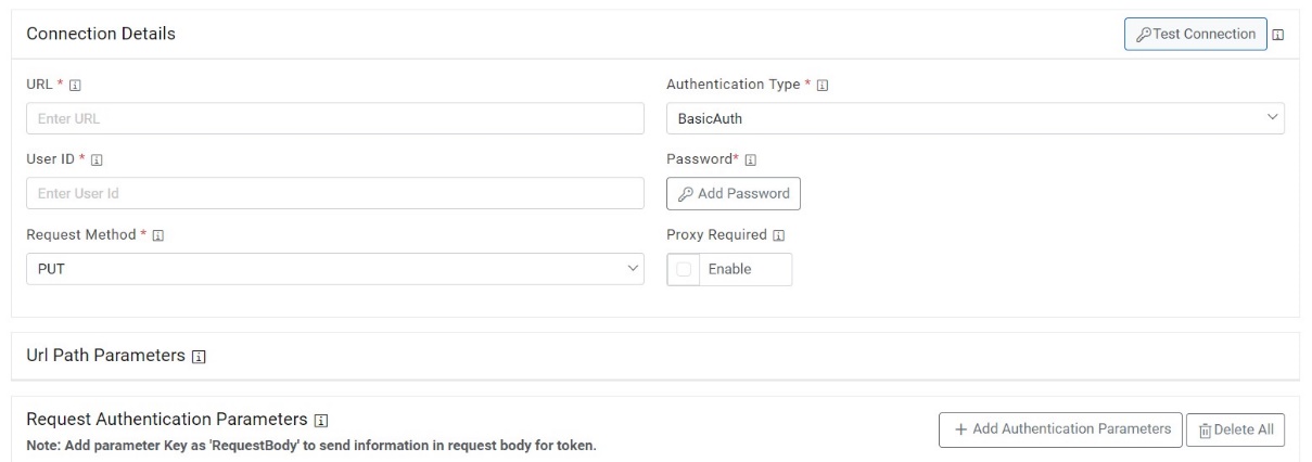

  4. Selection of Windows / Basic Authentication requires only Username and Password.
    Figure 8. Authentication Type (Windows / Basic)

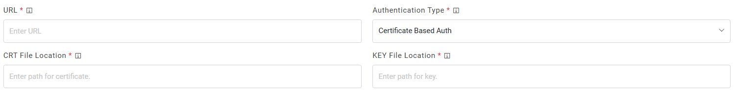

  5. Selection of Certificate based Auth requires CRT file location and Key file location of the certificate.
    Figure 9. Authentication Type (CRT / Key file location)

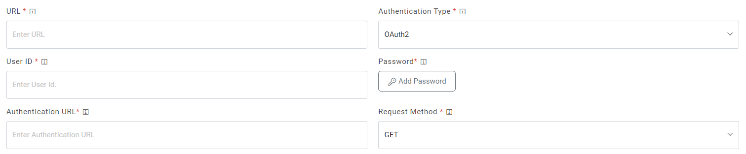

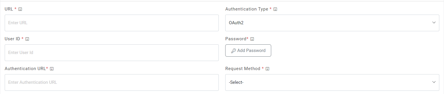

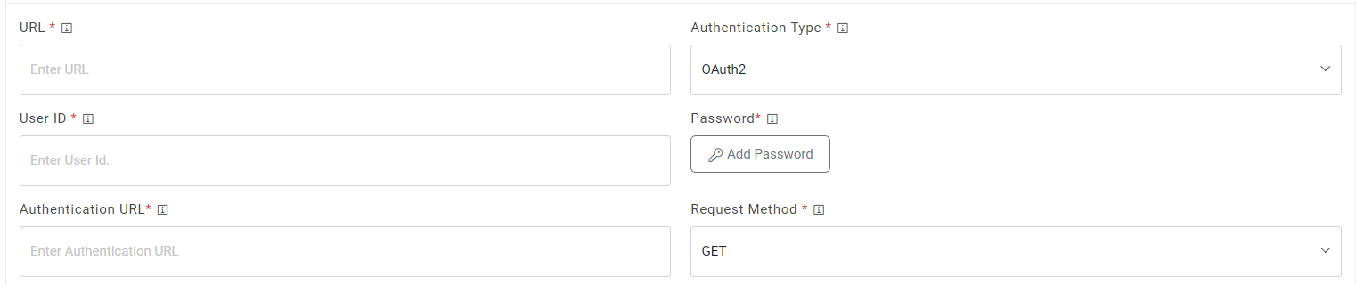

  6. Selection of OAuth2 authentication type, users needs to provide the below details:
    • Type the Authentication URL.
    • Type the Username and Password.

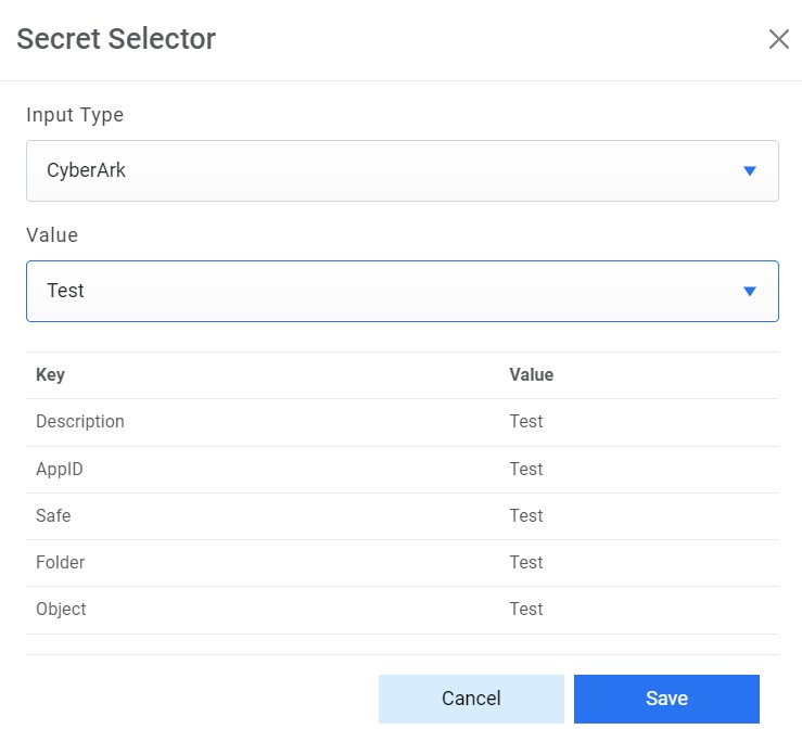

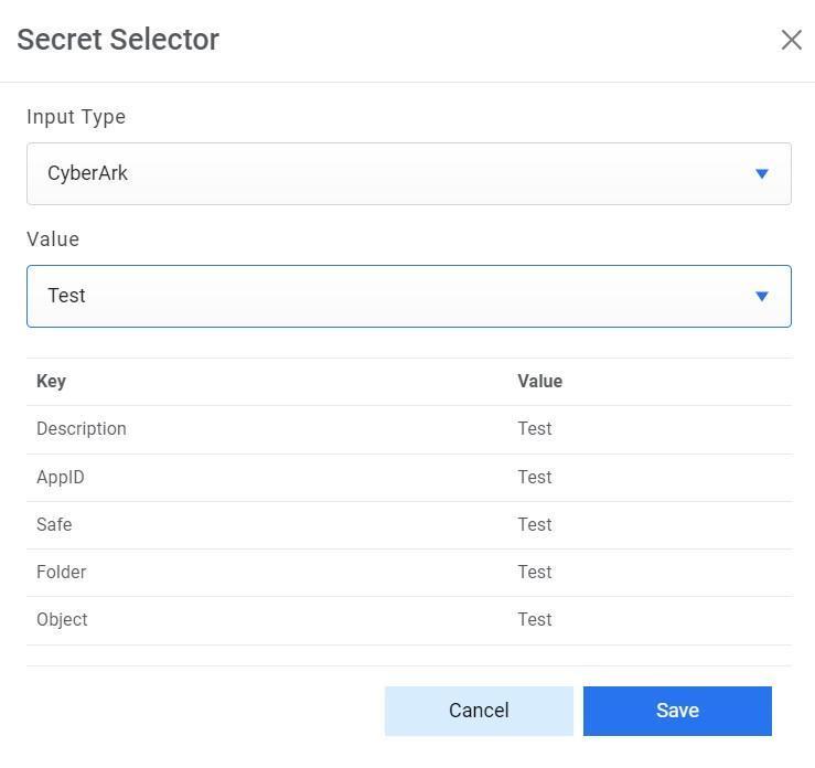

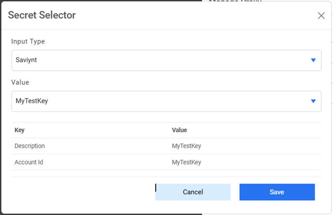

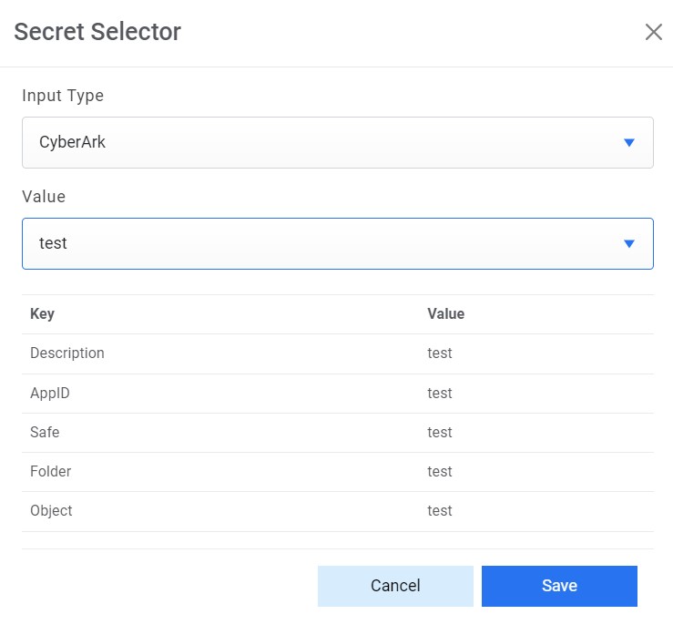

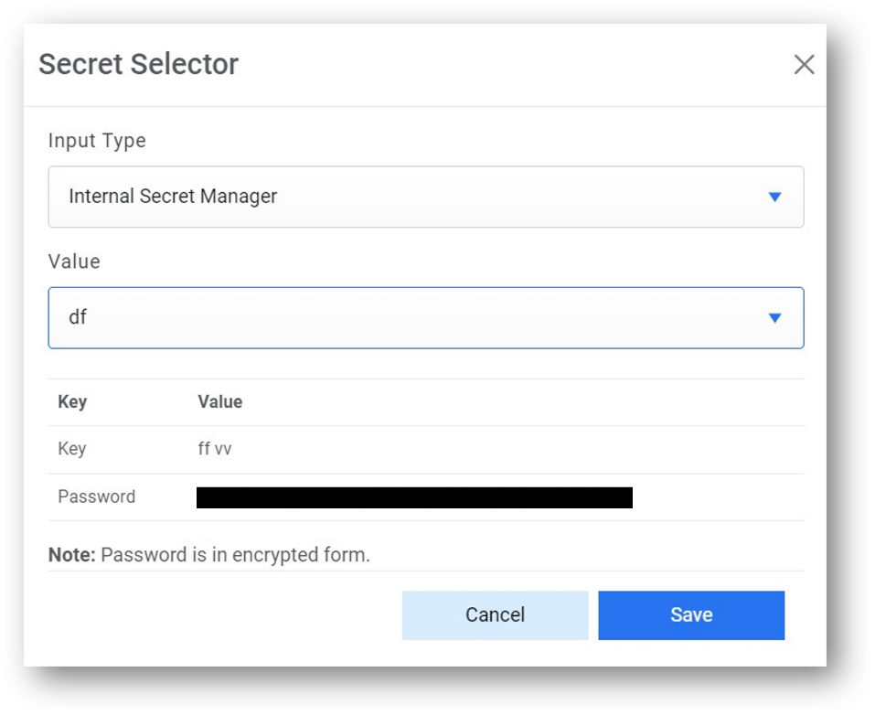

  7. For password, click on Add Password button next to it.If it is available in Azure Key Vault then select Input Type as Azure Key Vault and then select any of the configured details from the value field. Else if it is available in any Key Vault such as CyberArk or Secret Manager then select Input Type as CyberArk or Secret Manager and then select any of the configured details from the value field.
    Figure 10. Password from Key Vault (CyberArk)
    Figure 11. Password from Secret Manager

    Figure 13. Password from Saviynt Vault
    Figure 14. Authentication Type (OAuth2)

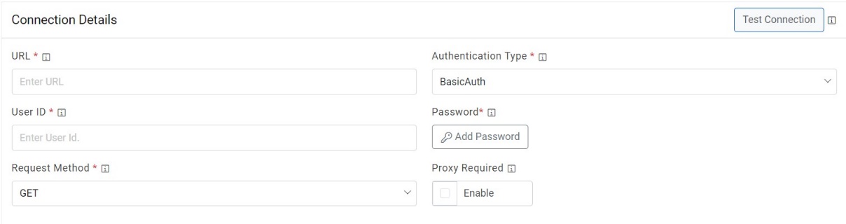

  8. Select Request Method as GET, PUT, POST or PATCH.
  9. Select Proxy Required if the environment needs access to content from data sources outside the firewall.
  10. Click on Test Connection to check accessibility of URL from service. Testing the connection is not mandatory, you can still create Data source.
  11. To test connection, the URL of ITSM should be whitelisted else it will throw alert stating ‘Use only WhiteListed URL ‘. To whitelist the URL kindly, refer ‘ HCL BigFix Runbook AI KRS Guide’ .

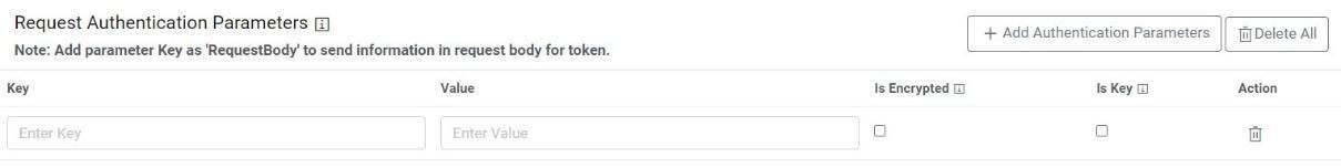

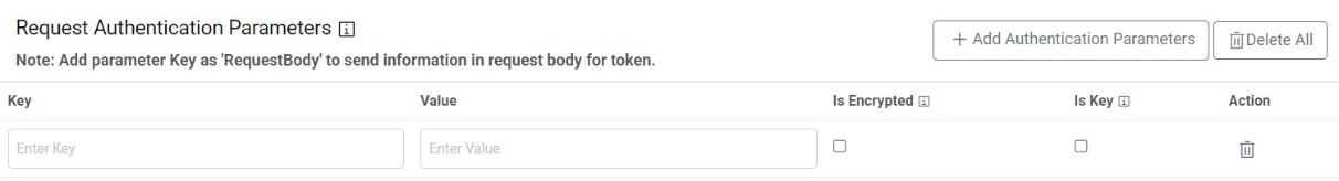

  12. If the user has additional parameters, click Add Authentication Parameters under the Request Authentication Parameters tab.
    Figure 15. Add Authentication Parameters

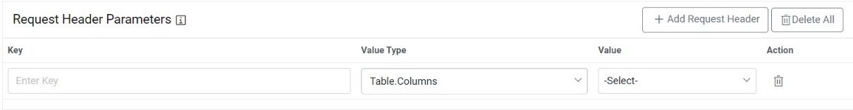

  13. Type the ‘Request Header Parameter’.
    Figure 16. Request Header Parameter

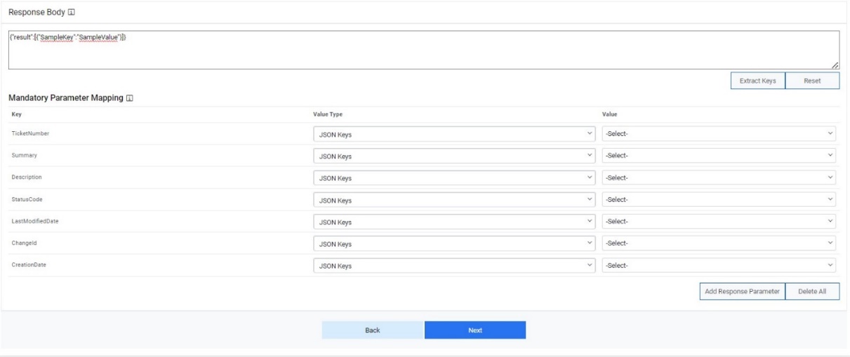

  14. Type the Request Body in JSON format.
  15. Type the Response Body in JSON format.
  16. Click Extract Keys . It adds the parameter and lists to the Mandatory page.
  17. Click Add the Response Parameter if you want to add a new parameter to the Mandatory page.
    Figure 17. Add response Parameter

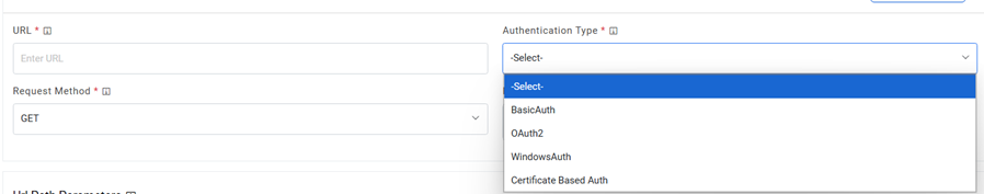

    • WindowsAuth
    • OAuth2
    • BasicAuth
    Figure 19. Authentication Types
    1. Selection of Windows / Basic authentication requires only Username and Password.
      Figure 20. Authentication Type (Windows / Basic)
    2. Selection of Certificate based Auth requires CRT file location and Key file location of the certificate..
      Figure 21. Authentication Type (CRT and Key file location )

    4. For password, click on Add Password button next to it.If it is available in Azure Key Vault then select Input Type as Azure Key Vault and then select any of the configured details from the value field. Else if it is available in any Key Vault such as CyberArk or Secret Manager then select Input Type as CyberArk or Secret Manager respectively and then select any of the configured details from the value field.
      Figure 22. Password from Key Vault (CyberArk)
      Figure 23. Password from Secret Manager

  4. Select Request Method as GET, PUT, POST or PATCH.
  5. Select Proxy Required if the environment needs access to content from data sources outside the firewall.
  6. Click on Test Connection to check accessibility of URL from service. Testing the connection is not mandatory, you can still create Data source.
  7. To test connection, the URL of ITSM should be whitelisted else it will throw alert stating ‘Use only WhiteListed URL ‘. To whitelist the URL kindly refer ‘ HCL BigFix Runbook AI KRS Guide’ .
  8. If the user has additional parameters, click Add Authentication Parameters under the Request Authentication Parameters tab.
    Figure 27. Authentication Type (Windows / Basic)

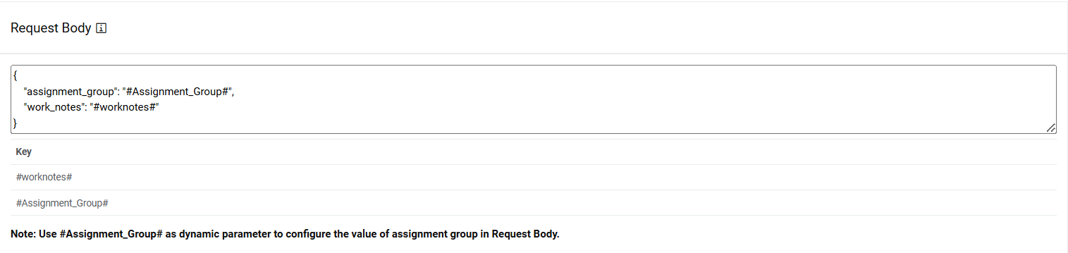

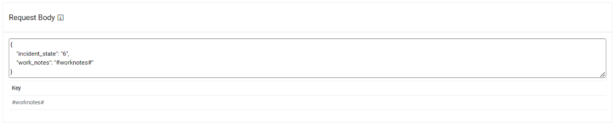

  10. Type the Request Body in JSON format.
    Figure 29. Request Body
    The values for the parameters will be set in the Mange Rules section.

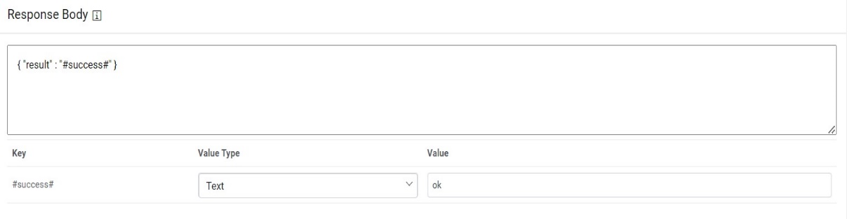

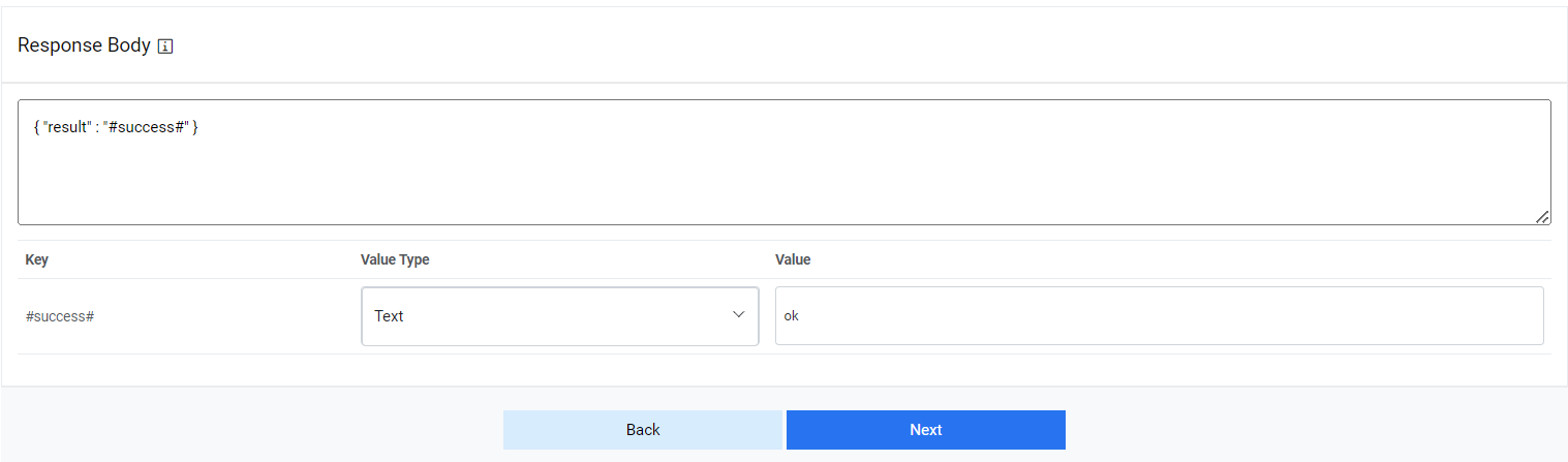

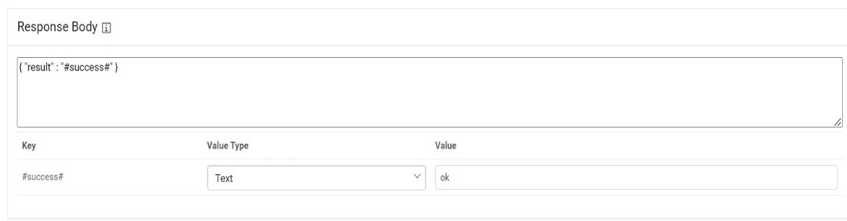

  11. Type the Response Body in JSON format.
    Figure 30. Response Body

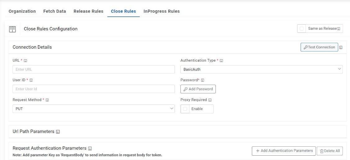

Users can configure the method for Closing the ticket from BigFix Runbook AI queue by performing the following steps.
Close Rules Configuration is only applicable for Incident Management, Service Request Task and Change Request Task
  1. On the Close Rules Configuration page, click on Same as Release if similar configurations as mentioned in “Release Rules Configuration” are required, else proceed ahead.
  2. Type the URL of the selected service type in the URL field to release data.
  3. This URL contains the placeholders that display the parameters based on the applied clause. It depends on the URL or API provided by the tool.
    Figure 31. Close Rules Configuration
    User can apply multiple clauses into the URL to display only the required parameter into the placeholder. Once you hit the URL, only the placeholders with a hashtag will be displayed with the associated parameters in the URL Path Parameters column. Whenever user wants to change the data to be filtered, always change the logic in the URL to get the specific parameters.

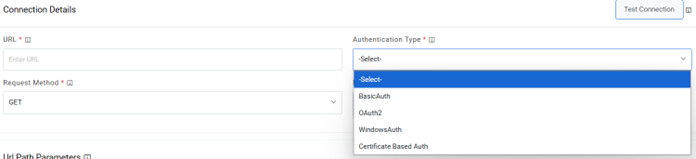

  4. Select the Authentication Type. BigFix Runbook AI supports the following types of authentications:
    • WindowsAuth
    • OAuth2
    • BasicAuth
    Figure 32. Authentication Types
      Figure 33. Authentication Type (Windows / Basic)
      Figure 34. Authentication Type (CRT and Key file location)

  9. If a user has additional parameters, click Add Authentication Parameters under the tab Request Authentication Parameters.
    Figure 40. Authentication Type (Windows / Basic)

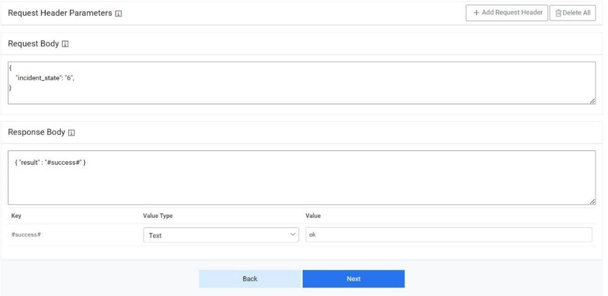

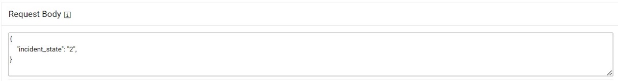

  11. Type the Request Body in JSON format.
    Figure 42. Request Body
  12. Type the Response Body in JSON format.
    Figure 43. Response Body
  13. Click Next to move to the next section.
    Figure 44. Request Header Parameter

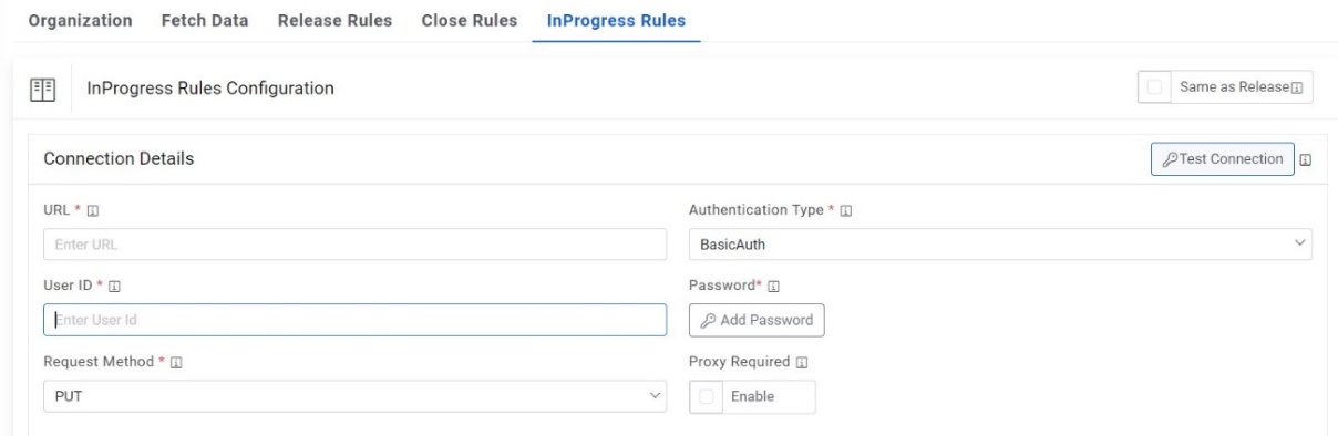

User can configure a method for releasing the ticket from BigFix Runbook AI queue performing the following steps.
InProgress Rules Configuration is only applicable for Incident Management, Service Request Task and Change Request Task
  1. On the InProgress Rules Configuration page, click on Same as Release if similar configurations as mentioned in “Release Rules Configuration” are required, else proceed ahead.
  3. This URL contains the placeholders that display the parameters based on the applied clause. It is dependent on the URL or API provided by the tool.
    Figure 45. InProgress Rules Configuration
    • WindowsAuth
    • OAuth2
    • BasicAuth

    1. Selection of Certificate based Auth requires CRT file location and Key file location of the certificate.
      Figure 47. Authentication Type (CRT and Key file location)

  5. Select Request Method as GET, PUT, POST or PATCH.
  6. Select Proxy Required if the environment needs access to content from data sources outside the firewall.
  7. Click on Test Connection to check accessibility of URL from service. Testing the connection is not mandatory, you can still create Data source.
    Figure 53. Authentication Type (Windows / Basic)
  10. Type the Request Header Parameter.
    Figure 54. Request Header Parameter
    Figure 55. Request Body
    The values for parameters will be set in the Mange Rules section.
    Figure 56. Response Body
  13. Click Submit to create the Data Source.

Assignation Rules
Users can configure the method for assigning the ticket from BigFix Runbook AI queue by performing the following steps.
Assignation Rules Configuration is only applicable for Incident Management, Service Request Task and Change Request Task Module for ServiceNow and ServiceXchange
  1. On the Assignation Rules Configuration page, click on Same as Release if similar configurations as mentioned in “Release Rules Configuration” are required, else proceed ahead.
    Figure 58. Assignation Rules Configuration
    Users can apply multiple clauses into the URL to display only the required parameter into the placeholder. Once you hit the URL, only the placeholders with a hashtag will be displayed with the associated parameters in the URL Path Parameters column. Whenever a user wants to change the data to be filtered, always change the logic in the URL to get the specific parameters.
    • WindowsAuth
    • OAuth2
    • BasicAuth
    • Figure 59. Authentication Types
      Figure 60. Authentication Type (Windows / Basic)
      Figure 61. Certificate based Auth
    3. Selection of OAuth2 authentication type, users needs to provide the below details.
    4. For password, click on Add Password button next to it. If it is available in Azure Key Vault then select Input Type as Azure Key Vault and then select any of the configured details from the value field. Else if it is available in any Key Vault such as CyberArk or Secret Manager then select Input Type as CyberArk or Secret Manager respectively and then select any of the configured details from the value field..
      Figure 62. Password from Key Vault (CyberArk)
      Figure 63. Password from Secret Manager
      Figure 64. Password from Azure Key Vault
      Figure 65. Password from Saviynt Vault
      Figure 66. Authentication Type (OAuth 2.0)
  8. To test connection, the URL of ITSM should be whitelisted else it will throw alert stating ‘Use only Whitelisted URL ‘. To whitelist the URL kindly refer ‘HCL BigFix Runbook AI KRS Guide’.
    Figure 67. Authentication Type (Windows / Basic)
    Figure 68. Request Header Parameter
    Figure 69. Request Body
    Figure 70. Response Body
    Figure 71. Request Header Parameter
    • WindowsAuth
    • OAuth2
    • BasicAuth
    Figure 73. Authentication Types
      Figure 75. CRT file location
      Figure 76. Password from Key Vault (CyberArk)
  8. To test connection, the URL of ITSM should be whitelisted else it will throw alert stating ‘Use only WhiteListed URL ‘. To whitelist the URL kindly refer ‘HCL BigFix Runbook AI KRS Guide’.
    Figure 81. Authentication Type (Windows / Basic)
    Figure 82. Request Header Parameter

View Data Sources
Users can view and manage the data sources configured within organization.
To view and manage data sources, perform the following steps:
  1. On the main menu bar, click Configuration Manage Data Sources.
  2. The Manage Data Sources page appears.
    Figure 86. View Data Source
This lists the available data sources in a tabular view with their associated organization, module, and service type. Users can create a new data source by clicking Manage Data Sources. Users can also edit or delete the data source and manage the entry criteria for the data source.

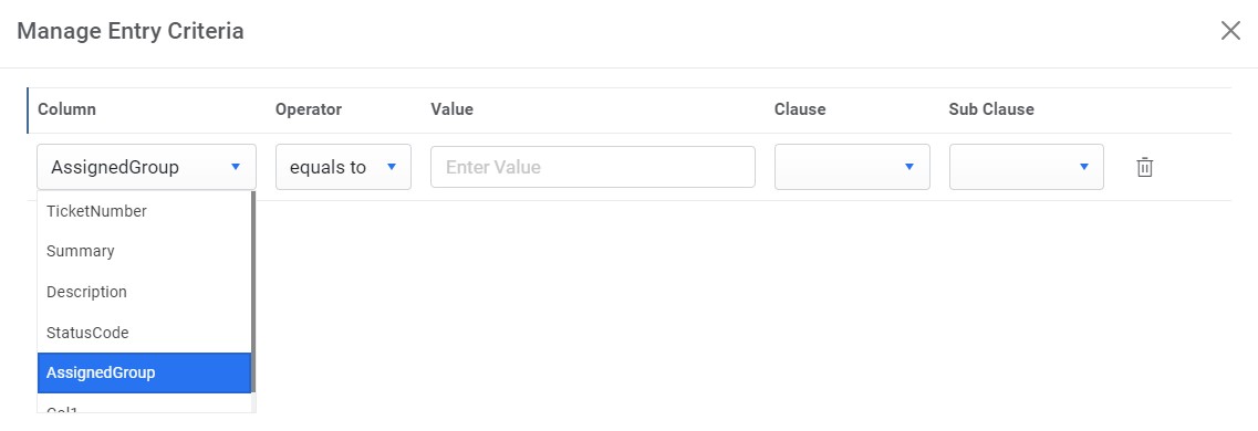

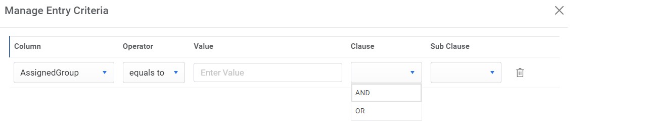

  2. The Manage Entry Criteria page appears. You will be prompted to apply the following conditions:
    • Column
    • Operator
    • Value
    • Clause
    • Sub-Clause
  3. Click Save to go to the next screen.
