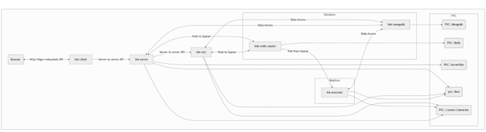

    Following is high level network flow for Link application
    Following are the default Ports that are used For networking.
    Pod For Http For https
    Service Port Container Port Service Port Container Port
    Client 80 8080/TCP 443 8443/TCP
    Server 8080 80/TCP 8443 8443/TCP
    Rest 8080 80/TCP 8443 8443/TCP
    • Executor, Mongodb and Redis Pods are independent pods, so they don’t need to expose any port
    • Client Server and Rest pods are interdependent, changing any port ,will require corresponding port mapping in other pods as well
