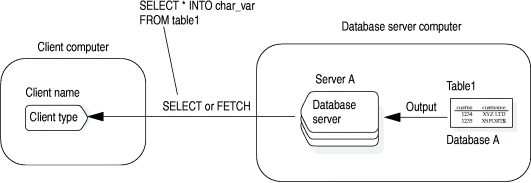

The database server calls the output function when it sends the external representation of an opaque type to a client application. For example, when a client application issues a SELECT or FETCH statement, the application can save the data of an opaque type that it receives from the database server in a character host variable. The database server calls the output function to convert the internal representation that is stored on disk to the external representation that the character host variable requires.
The following figure shows when the database server executes the output support function.
Figure 1. Execution of the output support function
begin figure description - This figure is described in the surrounding text. - end figure description
