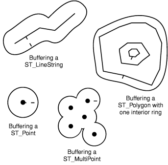

As shown in the following figure, ST_Buffer() generates a polygon or a multipolygon that surrounds a geometry at a specified radius.
Figure 1. Buffers generated by the ST_Buffer() function
This graphic shows the buffering of various geometric objects.
A single polygon results when a primary geometry is buffered or when the buffer polygons of a collection are close enough to overlap. When enough separation exists between the elements of a buffered collection, individual buffer ST_Polygons result in an ST_MultiPolygon.
