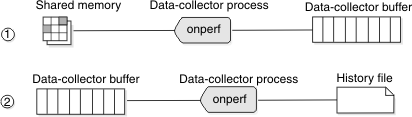

The onperf utility allows designated metrics to be continually buffered. The data collector writes these metrics to a circular buffer called the data-collector buffer. When the buffer becomes full, the oldest values are overwritten as the data collector continues to add data. The current contents of the data-collector buffer are saved to a history file, as How onperf saves performance data illustrates.
Figure 1. How onperf saves performance data
This figure is described in the previous paragraph.
