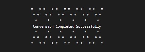

  9. Ensure that conversion of the primary was completed successfully and that the server is in multi-user mode. You should see the following in the message log: msglogimage
