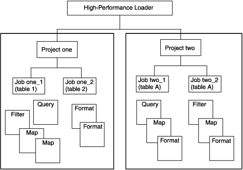

The following figure shows the relationships among projects, jobs, and components.
Figure 1. Illustration of project hierarchy
begin figure description - This figure is described in the surrounding text. - end figure description
The preceding figure shows that jobs are linked directly to the projects. The format, map, filter, and query components belong to a project but are not directly linked to a job, as illustrated with Project One. In general, you create a format, map, and filter or query for each job, as shown with Project Two. However, in some cases, you might use the same component for more than one job within a project.
For example, for reports about a medical study, you might want to create three reports: one about subjects under 50 years of age, one about subjects over 50, and one about all subjects. In that case, the description of how to find the information (the format and map) is the same for all three reports, but the selection of information (the query) is different for each report. (Formats, maps, and queries are described in detail in later chapters.)

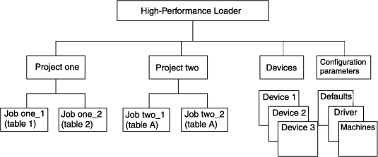

All components (maps, formats, queries, filters, and load and unload jobs) that you create in a project are associated with that project in the onpload database. Components that are associated with a project are visible (usable) only when the project is selected. When you select a different project, a different set of components becomes available.
Device-array definitions and configuration parameters are not included in project definitions. The following figure shows the components that the HPL uses. Each project is distinct, but the devices and configuration parameters apply to all projects.
Figure 2. Relationship of projects, devices, and configuration parameters
