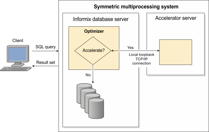

The accelerator server and the database server on the same computer
The following figure shows the accelerator server and the database server installed on the same computer.
Figure 1. The accelerator server and the database server installed on the same computer.
Begin figure description - Most of the figure is described by the surrounding text. The figure shows a client computer connected to a symmetric multiprocessing system (SMP). The client is used to send queries to and receive results sets back from the database server. Inside the Informix database server, the query optimizer determines if the accelerator server can process the query. If yes, the query is sent to the accelerator server over a local loopback TCP/IP connection between the database server and the accelerator server. If no, the query is processed by the query optimizer on the database server. - end figure description

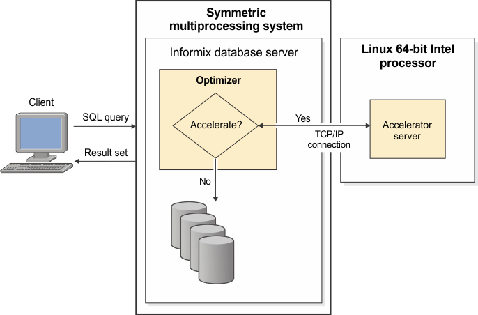

The accelerator server and the database server on different computers
The following figure shows the accelerator server and the database server installed on different computers.
Figure 2. The accelerator server and the database server installed on different computers.
Begin figure description - This figure is similar to the previous figure, but shows the accelerator server installed on a separate computer. A client computer is connected to a symmetric multiprocessing system (SMP). - end figure description
