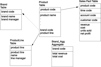

you are using an aggregate of the fact table. For example, if you
have brand information that you want to separate out from a product dimension
table, you can create a brand snowflake that consists of a single
row for each brand and that contains significantly fewer rows than
the product dimension table. The following figure shows a snowflake
structure for the brand and product line elements and the brand_agg aggregate
table. Figure 1. An example
of a snowflake schema
If you create an aggregate table, brand_agg, that consists
of the brand code and the total revenue per brand, you can use the
snowflake schema to avoid the join to the much larger sales table.
For example, you can use the following query on the brand and brand_agg tables:

If an aggregate table is not available, any joins to a dimension
element that was normalized with a snowflake schema must now be a
three-way join, as the following query shows. A three-way join reduces
some of the performance advantages of a dimensional database.
