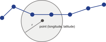

Run the STS_TrajectoryCross function to know whether an object crossed the boundary of a specific region during a time range.
The following illustration shows a trajectory that crosses the boundary of the region.
Returns
t = The object crossed the boundary of the region during the time range.
f = The object did not cross the boundary of the region during the time range.

Vehicle 1002 crossed the boundary of the region.
