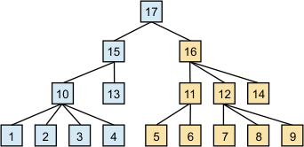

Example of a Hierarchical Data Set
In several topics that follow, SQL code examples that illustrate hierarchical queries are based on hierarchic data in the following employee table, whose rows contains information about employees within an organizational hierarchy. The mgrid column shows the employee identifier (empid) of the manager to whom the employee reports:

INSERT INTO employee VALUES (17, 'Urbassek', 95000, NULL);Each pair of empid and mgrid values express referential relationships that the recursive iterations of a query with an appropriate CONNECT BY condition can correctly assemble into a hierarchy.
Here the
NULL value in the mgrid column in the last row shows that employee Urbassek,
whose empid value is 17 is the root node of
this reporting hierarchy.
The following diagram illustrates the four levels of the reporting hierarchy (with nodes that show the empid values) for the employee table data:
