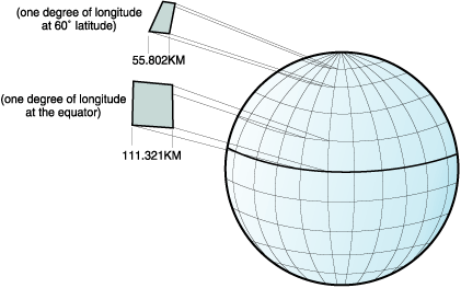

The latitude and longitude lines can cover the globe to form a grid, called a graticule. The point of origin of the graticule is (0,0), where the equator and the prime meridian intersect. The equator is the only place on the graticule where the linear distance corresponding to one degree latitude is approximately equal the distance corresponding to one degree longitude. Because the longitude lines converge at the poles, the distance between two meridians is different at every parallel. Therefore, as you move closer to the poles, the distance corresponding to one degree latitude is much greater than the distance corresponding to one degree longitude.
It is difficult to determine the lengths of the latitude lines using the graticule. The latitude lines are concentric circles that become smaller near the poles. They form a single point at the poles where the meridians begin. At the equator, one degree of longitude is approximately 111.321 kilometers, while at 60 degrees of latitude, one degree of longitude is only 55.802 km (this approximation is based on the Clarke 1866 spheroid). Therefore, because there is no uniform length of degrees of latitude and longitude, the distance between points cannot be measured accurately by using angular units of measure.
The following illustration shows the different dimensions between locations on the graticule.
Figure 4. Different dimensions between locations on the graticule
The length of one degree of longitude becomes smaller along the latitude lines as you move closer to the poles.

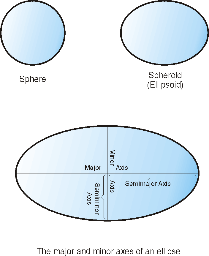

A coordinate system can be defined by either a sphere or a spheroid approximation of the Earth's shape. Because the Earth is not perfectly round, a spheroid can help maintain accuracy for a map, depending on the location on the Earth. A spheroid is an ellipsoid that is based on an ellipse, whereas a sphere is based on a circle.
The shape of the ellipse is determined by two radii. The longer radius is called the semimajor axis, and the shorter radius is called the semiminor axis. An ellipsoid is a three-dimensional shape that is formed by rotating an ellipse around one of its axes.
The following illustration shows the sphere and spheroid approximations of the Earth and the major and minor axes of an ellipse.
Figure 5. Sphere and spheroid approximations
A sphere, a spheroid (ellipsoid), and the major and minor axes of an ellipse.

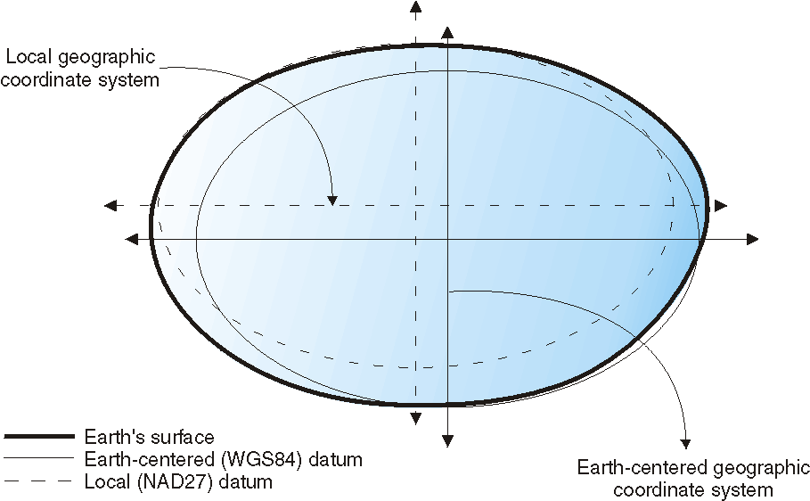

A datum is a set of values that defines the position of the spheroid relative to the center of the Earth. The datum provides a frame of reference for measuring locations and defines the origin and orientation of latitude and longitude lines. Some datums are global and intend to provide good average accuracy around the world. A local datum aligns its spheroid to closely fit the Earth's surface in a particular area. Therefore, the coordinate system's measurements are not accurate if they are used with an area other than the one that they were designed.
The following illustration shows how different datums align with the Earth's surface. The local datum, NAD27, more closely aligns with Earth's surface than the Earth-centered datum, WGS84, at this particular location.
Figure 6. Datum alignments
Local datum NAD27 more closely aligned with Earth's surface than datum WGS84.
Whenever you change the datum, the geographic coordinate system is altered and the coordinate values change. For example, the coordinates in DMS of a control point in Redlands, California using the North American Datum of 1983 (NAD 1983) are: "-117 12 57.75961 34 01 43.77884" The coordinates of the same point on the North American Datum of 1927 (NAD 1927) are: "-117 12 54.61539 34 01 43.72995".
