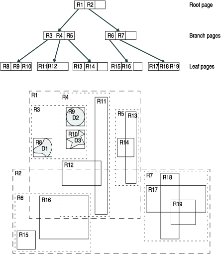

The lower part of the following figure shows a set of bounding boxes that enclose data objects and other bounding boxes. In the diagram, the data objects are shaded.
Important: Data objects are only shown for bounding boxes R8, R9, and R10. The other bounding boxes at the leaf level (R11 through R19) also contain data items, but they are omitted from the figure to simplify the graphic.
Figure 1. R-tree index structure
As the figure shows, bounding boxes can enclose a single data object or one or more bounding boxes. For example, bounding box R8, which is at the leaf level of the tree, contains the data object D1. Bounding box R3, which is at the branch level of the tree, contains the bounding boxes R8, R9, and R10. Bounding box R1, which is at the root level, contains the bounding boxes R3, R4, and R5.
