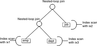

The diagram in Possible
query plan without directives shows
a possible query plan for this query. The query plan has three levels
of information: (1) a nested-loop join, (2) an index scan on one table
and a nested-loop join, and (3) index scans on two other tables.Figure 1. Possible
