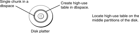

Placing high-use tables on middle partitions of disks
To minimize disk-head movement, place the most frequently accessed data on partitions close to the middle band of the disk (not near the center and not near the edge). This approach minimizes disk-head movement to reach data in the high-demand table.
The following figure shows the placement of the most frequently accessed data on partitions close to the middle band of the disk.
Figure 1. Disk platter with high-use table located on middle Partitions
This figure is described in the surrounding text.
To place high-use tables on the middle partition of the disk, create a raw device composed of cylinders that reside midway between the spindle and the outer edge of the disk. (For instructions on how to create a raw device, see the HCL® Informix® Administrator's Guide for your operating system.) Allocate a chunk, associating it with this raw device, as your HCL® Informix® Administrator's Reference describes. Then create a dbspace with this same chunk as the initial and only chunk. When you create a high-use table, place the table in this dbspace.
