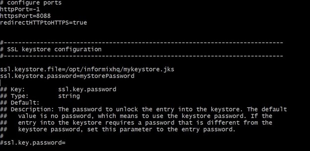

    Once you have the keystore, secure the InformixHQ web user interface and REST API by configuring HTTPS in the InformixHQ server. To configure HTTPS in the InformixHQ server, in your InformixHQ server properties file, set the httpsPort, ssl.keystore.file, and ssl.keystore.password properties and potentially also the ssl.key.password property if your key password is different from the keystore password.
    Additionally, if you want to disable HTTP access to the InformixHQ so that all communication to and from the InformixHQ server uses HTTPS, set the httpPort to -1 in your properties file. If instead you would like the InformixHQ server to automatically redirect all HTTP traffic to the HTTPS port, set the redirectHTTPtoHTTPS property to true.
    Figure 1. Sample InformixHQ server properties file with HTTPS enabled
    This figure shows sample InformixHQ server properties file with HTTPS enabled:.

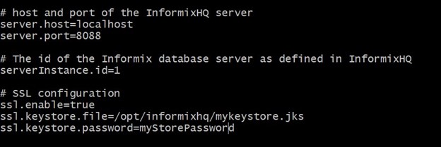

  • Once you have HTTPS enabled in the InformixHQ server, you must configure your InformixHQ agents to encrypt their web socket communication with the InformixHQ server. If you use the Deploy Agent button in the UI to have the InformixHQ server automatically deploy the agent, it will automatically configure the agent to use SSL if the InformixHQ server has HTTPS enabled.
    If you are starting your agents manually to enable SSL, set the ssl.enable property to true in your agent configuration file and then set the ssl.keystore.file property, the ssl.keystore.password property.
    Figure 2. Sample InformixHQ server properties file with SSL enabled
    This figure shows sample InformixHQ server properties file with SSL enabled:.
