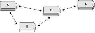

Different sites can have different levels. For example, Database Servers with Different Compression Levels shows a set of three root servers connected with LAN and a nonroot server connected over a modem. The CDR_NIFCOMPRESS configuration parameter is set so that connections between A, B, and C use no compression. The connection from C to D uses level 6.
Figure 1. Database Servers with Different Compression Levels
begin figure description - This figure is described in the surrounding text - end figure description
