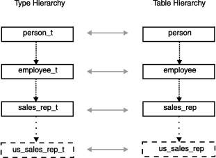

the hierarchy. However, you can add new subtypes and subtables to
an existing hierarchy provided that the new subtype and subtable do
not interfere with existing inheritance relationships. The following
figure illustrates one way that you might add a type and corresponding
table to an existing hierarchy. The dashed lines indicate the added
subtype and subtable. Figure 1. Example
of how you might add a subtype and subtable to an existing inheritance
hierarchy
CREATE ROW TYPE us_sales_rep_t (domestic_sales DECIMAL(15,2))
UNDER employee_t;
CREATE TABLE us_sales_rep OF TYPE us_sales_rep_t
UNDER sales_rep;

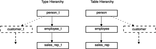

You can also add subtypes and subtables that branch from
an existing supertype and its parallel supertable. The following figure
shows how you might add the customer_t type and customer table
to existing hierarchies. In this example, both the customer table
and the employee table inherit properties from the person table.
Figure 2. Example of Adding a
Type and Table Under an Existing Supertype and Supertable
The following statements create the customer_t type
and customer table under the person_t type and person table,
respectively:
CREATE ROW TYPE customer_t (cust_num INTEGER) UNDER person_t;
CREATE TABLE customer OF TYPE customer_t UNDER person;
