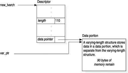

The following figure shows the format of the varying-length structure that new_lvarch references after the preceding call to mi_get_vardata() successfully completes.
Figure 1. Getting the data pointer from a varying-length structure
You can then access the data through the var_ptr data pointer, as the following code fragment shows:
