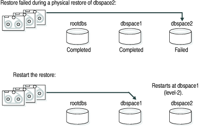

The physical restore restarts at the storage space and level where the failure occurred. If the restore failed while some, but not all, chunks of a storage space were restored, all chunks of that storage space are restored. If storage spaces and incremental backups are restored successfully before the failure, they are not restored again.

The following figure shows how a restartable restore works when the restore failed during a physical restore of dbspace2. The level-0, level-1, and level-2 backups of rootdbs, and the level-0 and level-1 backups of dbspace1 and dbspace2 are successfully restored. The database server fails while restoring the level-1 backup of dbspace2. When you restart the restore, restores the level-2 backup of dbspace 1, the level-1 and level-2 backups of dbspace2, and the logical logs.

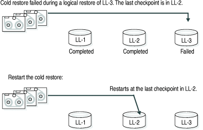

If a restore fails during the logical phase and you restart the restore, verifies that the storage spaces are restored, skips the physical restore, and restarts the logical restore. The following figure shows a cold restore that failed while restoring logical log LL-3. When you restart the cold logical restore, log replay starts from the last restored checkpoint. In this example, the last checkpoint is in logical log LL-2.
If a failure occurs during a cold logical restore, restarts the restore at the place of failure.
