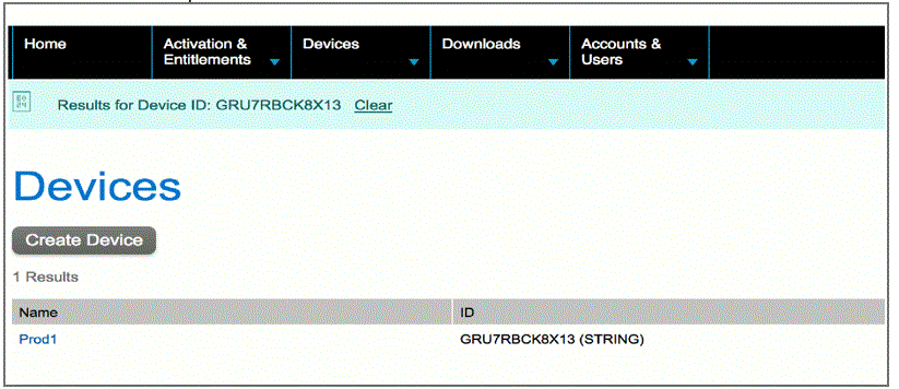

When the IDS instances are online it is possible to see their license holdings in the FlexNet Operations customer portal. You can drill down to get the details, starting with the Server Device. This is the device name that is in the LICENSE_SERVER URL. So for a LICENSE_SERVER value of https://hclsoftware.compliance.flexnetoperations.com/instances/GRU7RBCK8X13/ request, you would search in the portal for the Server Device ID GRU7RBCK8X13.

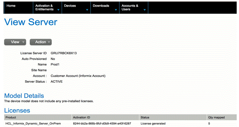

Click on the returned Device Name, Prod1, and you will see the details of the server device
The total number of licenses available is 5.
