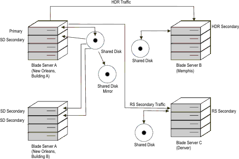

Figure 1. Configuration for three-tiered server availability
This figure illustrates a three-tier redundant server configuration. A blade server houses the primary server together with an SD secondary server sharing a mirrored disk array. The blade server is located in Building A in New Orleans. A second blade server houses two SD secondary servers in Building B next door. An HDR secondary server is configured as part of a third blade server located hundreds of miles from the primary server in Memphis. A fourth blade server is configured with an RS secondary server located over a thousand miles away from the primary server in Denver.

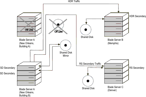

Now suppose that a local outage occurred in Building-A on the New Orleans campus. Perhaps a pipe burst in the machine room causing water damage to the blade server and the primary copy of the shared disk subsystem. You can switch the role of primary server to Building-B by running onmode -d make primary servername on one of the SD secondary servers running on the blade server in Building-B. This would cause all other secondary nodes to automatically connect to the new primary node.
Figure 2. First tier of protection
The paragraph that precedes this figure describes the content of the figure.

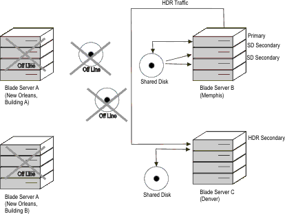

If there be a regional outage in New Orleans such that both building A and building B were lost, then you can shift the primary server role to Memphis. In addition, you might also want to make Denver into an HDR secondary and possibly add additional SD secondary servers to the machine in Memphis.
Figure 3. Second tier of protection

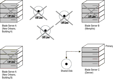

An even larger outage which affected both sites would require switching to the most remote system.
Figure 4. Third tier of protection
