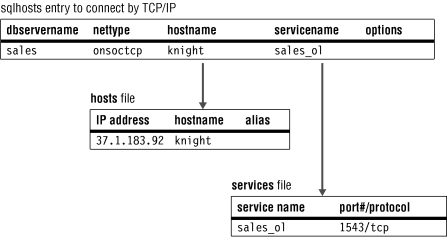

The following figure shows the relationship between the sqlhosts information and the hosts file, and the relationship of sqlhosts information to the services file.
Figure 1. Relationship of sqlhosts information to hosts and services files
This figure shows sample data in the sqlhosts information, the hosts file, and the services file. The sqlhosts information and the hosts file contain the same host name field. The sqlhosts information and the services file contain the same service name field.
