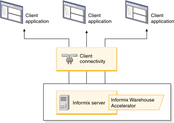

processes warehouse queries more quickly than the Informix® database server. improves performance while at the same time reduces administration. There are only a few configuration parameters that you need to set to tune query performance. You can install on same computer as the Informix® database server, as shown in the following figure. You can also install on a separate computer.
Figure 1. installed on the same computer as the Informix® database server.
begin figure description - Architecture of the Informix Warehouse Accelerator with the Informix database server. Shows installed on the same computer as the Informix database server. You can also install on a separate computer. - end figure

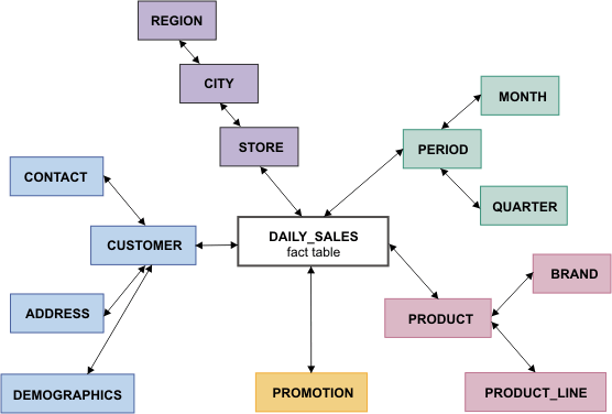

The following figure shows a sample snowflake schema with a fact table and multiple dimension tables.
Figure 2. A sample snowflake schema that has the DAILY_SALES table as the fact table.
Begin figure description - The figure shows the DAILY_SALES fact table in the center of the figure. This fact table is linked to five dimension tables: STORE, PERIOD, PRODUCT, PROMOTION, and CUSTOMER. The STORE table is linked to the CITY table. The CITY table is linked to the REGION table. The PERIOD table is linked directly to the MONTH and QUARTER tables. The PRODUCT table is linked directly to the BRAND and PRODUCT_LINE tables. The PROMOTION table is not linked to any other tables. The CUSTOMER table is linked directly to three tables: CONTACT, ADDRESS, and DEMOGRAPHICS. - end figure
