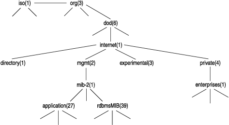

The MIB hierarchy
All MIBs are part of an information hierarchy that the Internet Assigned Numbers Authority (IANA) defines. The hierarchy defines how to name tables and columns and how to derive the numeric object identifiers (OIDs). The following figure shows the MIB hierarchy.
Figure 1. MIB hierarchy
begin figure description - This figure is described in the surrounding text. - end figure description
Even though you rarely see the full path to a table, column, or value, the path is important because the SNMP components use the numeric equivalent of the path to locate data. For example, the following value is the path to the Application MIB:
iso.org.dod.internet.mgmt.mib-2.application
An OID is the numeric equivalent of a path. It uniquely describes each piece of data that an SNMP Network Manager can obtain and is written as a string of numbers separated by periods (.). For example, the following value is the OID for the Application MIB:
1.3.6.1.2.1.27
The following value is the OID for a value in the Application MIB:
1.3.6.1.2.1.27.1.1.8.2
The first part of this OID is the OID for the Application MIB. The final part of the OID assigns values sequentially to each table in the MIB, each column in the table, and each value in a column.
