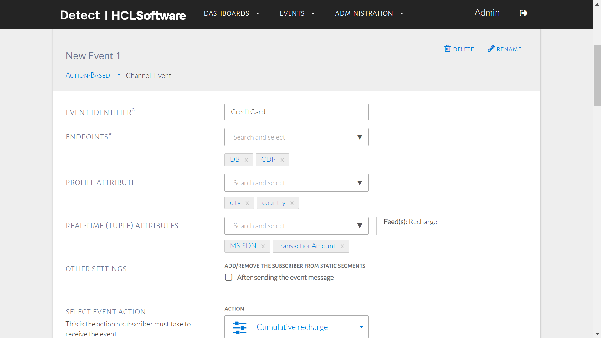

A sample screenshot shown below within an event configured in Detect where we select the attributes and populate an event identifier to push to downstream Kafka topic for Unica Journey to ingest.
Sample message output to the Kafka topic based on the configuration above.
"data": [
"eventID": "EVNT00031", # Value configured from UI
"country": "India", # Profile Attribute
"creditScore": "730", # Profile Attribute
"MSISDN": "9881153326", # Tuple Attribute
"city": "Chennai", # Profile Attribute
"transactionAmount": "200.0", # Tuple Attribute
"dataSource": "Transfer" # Tuple Attribute
