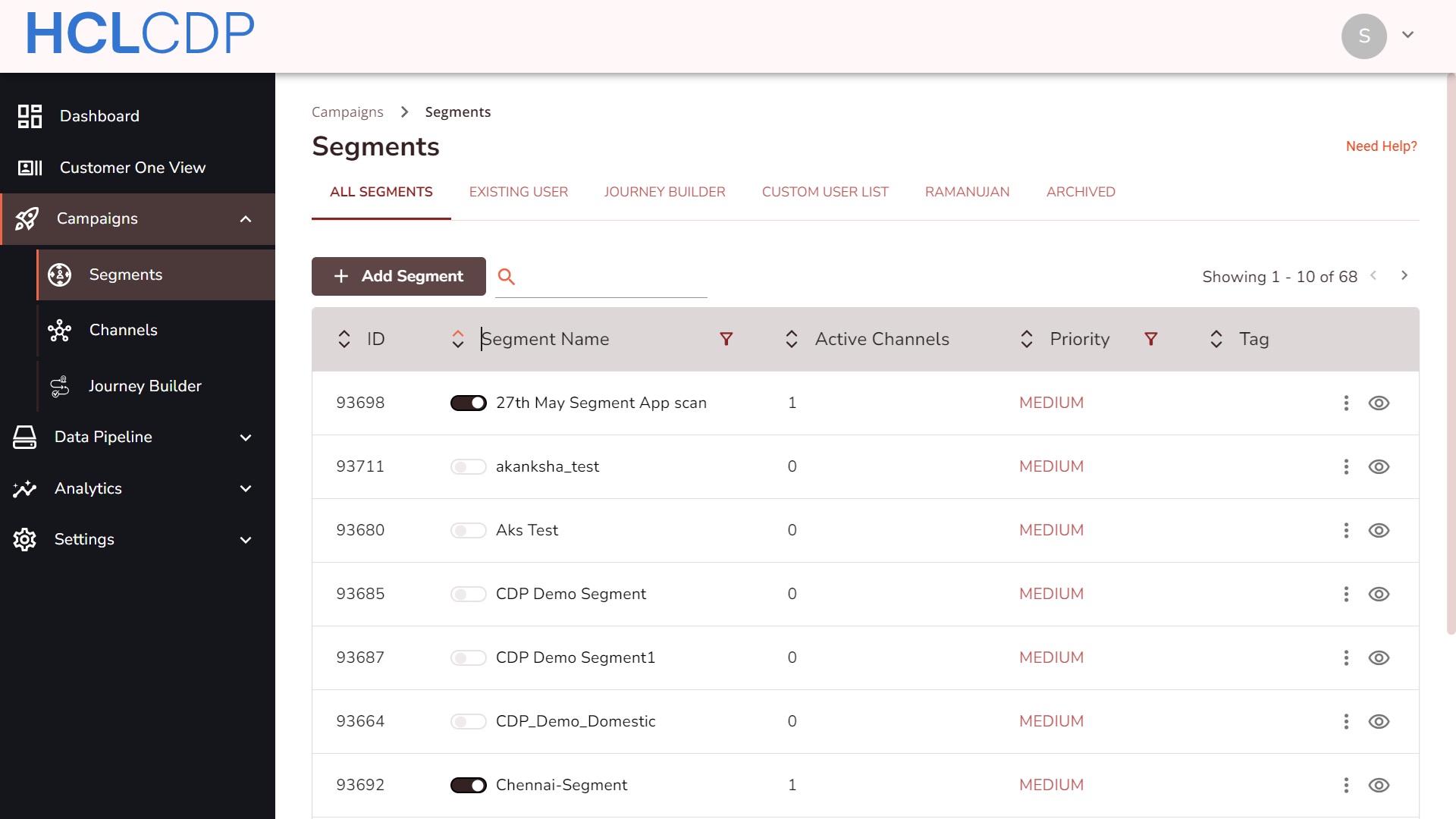

Segments Page
The Segments page displays all active, existing users, journey and archived segments and includes the following attributes:
  1. Toggle Switch: Activate or deactivate a segment.
  2. Segment Name: The name of the segment.
  3. Active Channels: The total number of channels with engagements for this segment.
  4. Segment ID: A unique identifier for each segment.
  5. Priority: Priority level (High, Medium, Low).
  6. Tags: Labels for segment identification.

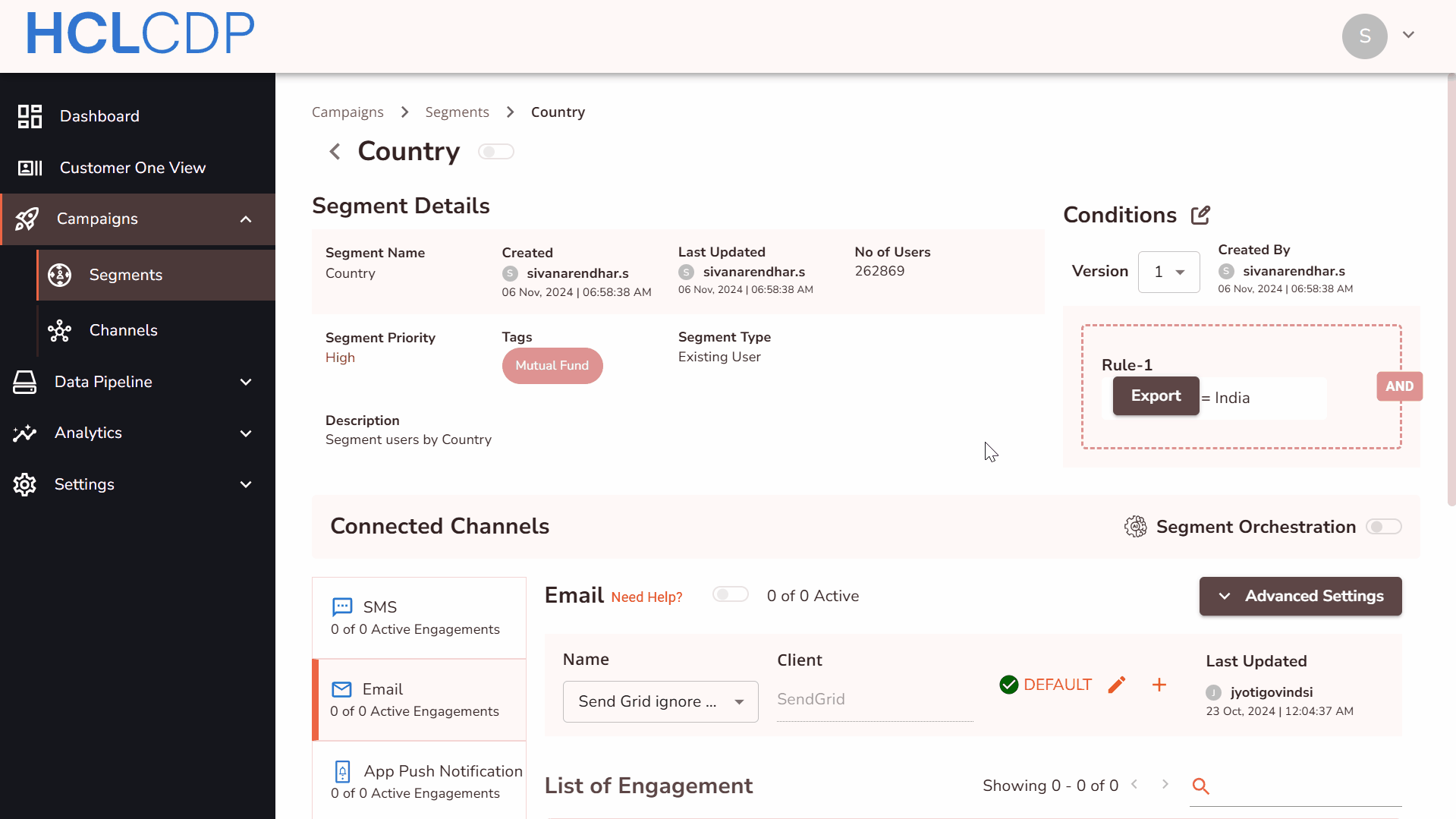

Edit a Segment
To edit your segment and make changes to it, follow the steps below:
  1. On the Segments page, click the name of the segment you want to edit.
  2. Click the edit (📝) icon next to Conditions, to start the editing, and implement changes to the Segment.
  3. Click Save to apply the changes made. As a result, a pop-up window will appear to review the active engagements and journeys linked to the segment.
  4. Click Confirm Segment Edit after reviewing the changes made.
  5. As a result, a pop-up window will appear notifying the Segment Edited Successfully.
  6. Click View the Segment to examine the changes made, and click the Version drop-down to view different versions of the segment.

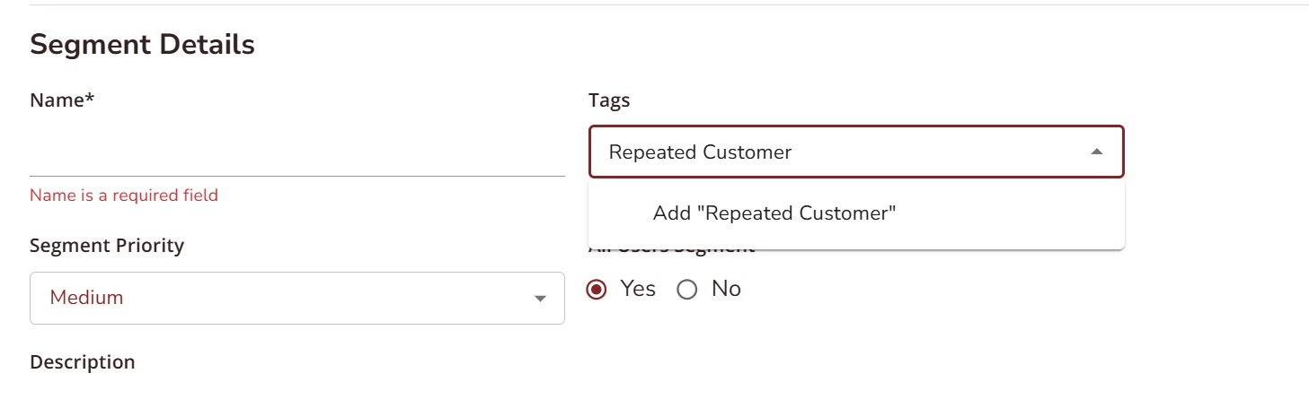

Add a Tag
You can add multiple tags to a segment in the HCL CDP Marketing Automation platform to categorize and organize it effectively. These tags can be edited for existing segments as well.
To add a tag, in the Tags drop-down, enter the tag name and click Add tag name.
