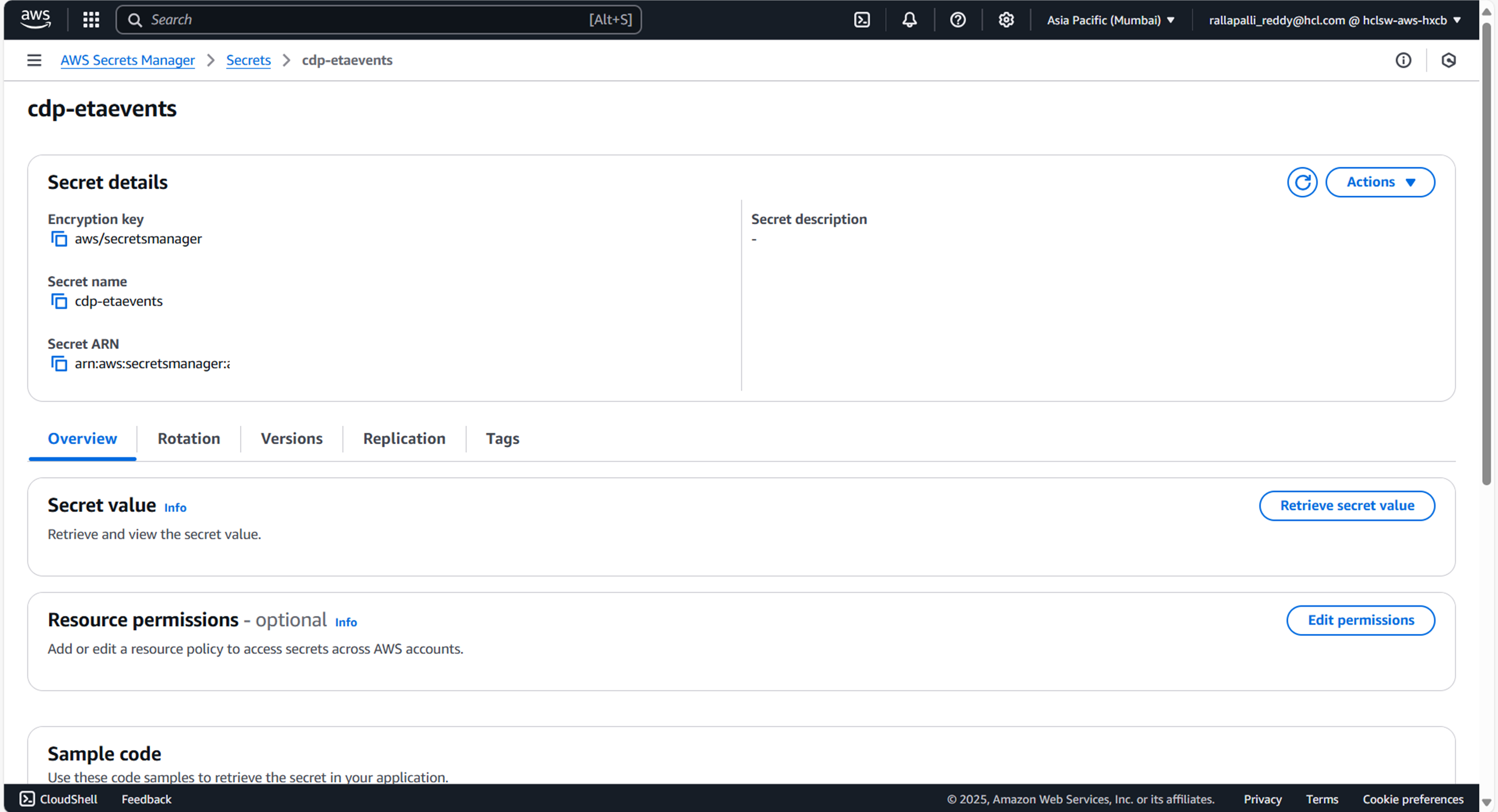

Make sure to create a cdp-etaevents secret in the AWS secret manager before deploying CDP ETA Events.
To create a CDP Etaevents secret in the AWS secret manager , follow the steps below:
  1. Create a cdp-etaevents secret sample key and value, and update the actual values as shown below.
      "KafkaConsumerConfig": "",
      "KafkaProducerConfig": "",
      "REDIS_SERVER_IP": "",
      "REDIS_SERVER_PORT": "6379",
      "KAFKA_PRODUCER_HOSTNAME": "etaeventshclhost",
      "TSDB_HOST": "",
      "TSDB_PORT": "80",
      "KAFKA_TOPIC_CONSUMER_DEFAULT_BATCH_TIMEOUT_MS": "1000,1000,1000",
      "KAFKA_TOPIC_CONSUMER_DEFAULT_BATCHTIMEOUT_TRIGGER": "5000,5000,5000",
      "MIN_KAFKA_MESSAGE_SEGMENTS": "CeleryETALem::4|ETACallback::2",
      "KAFKA_MESSAGE_TIMESTAMP_INDEX": "CeleryETALem::1|ETACallback::0",
      "KafkaProducerConfigaps1": ""

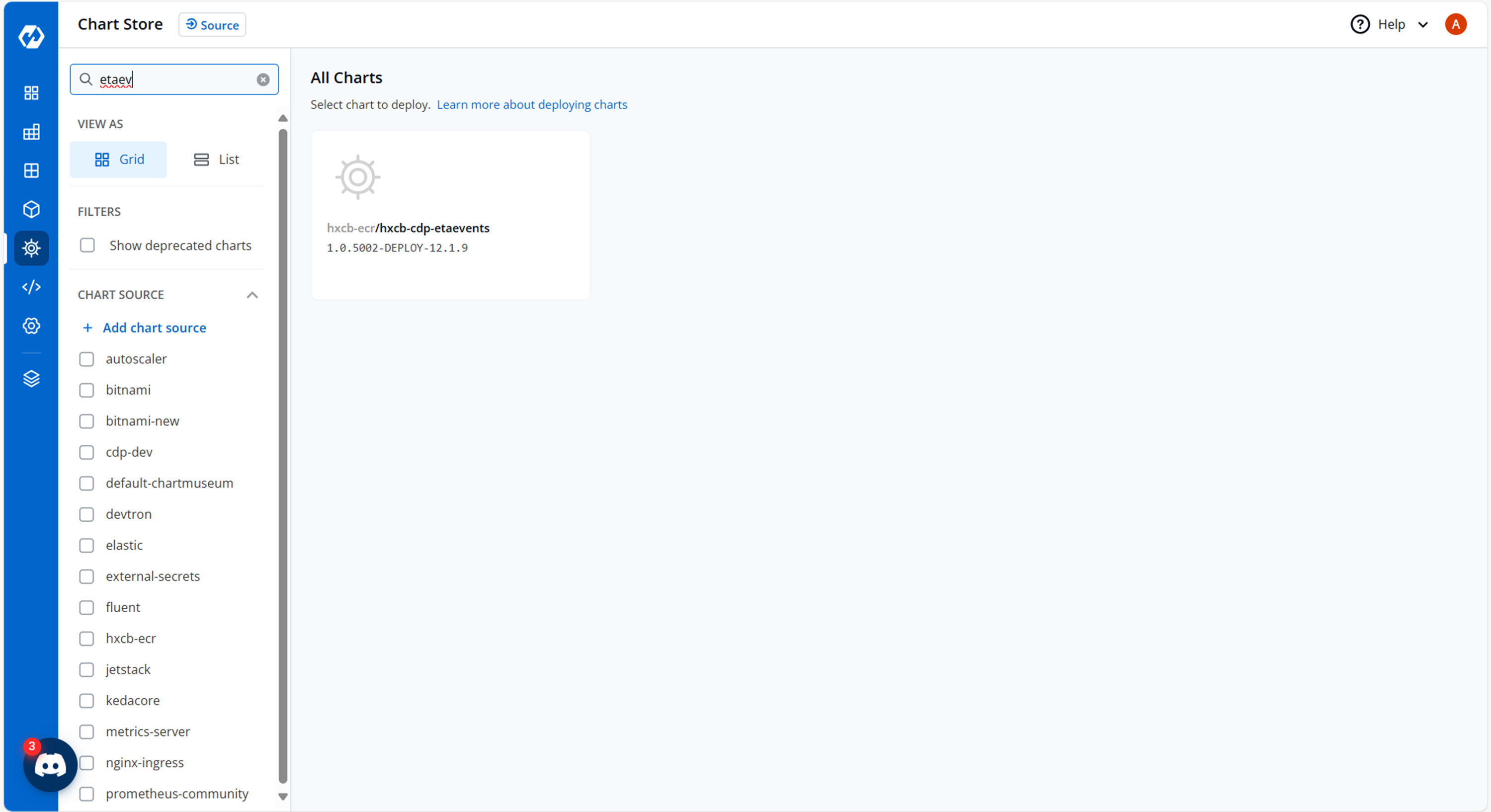

  1. Navigate to the Devtron Chart Store, and select the cdp-etaevents chart to deploy.
  2. Now, configure and deploy the cdp-etaevents charts.

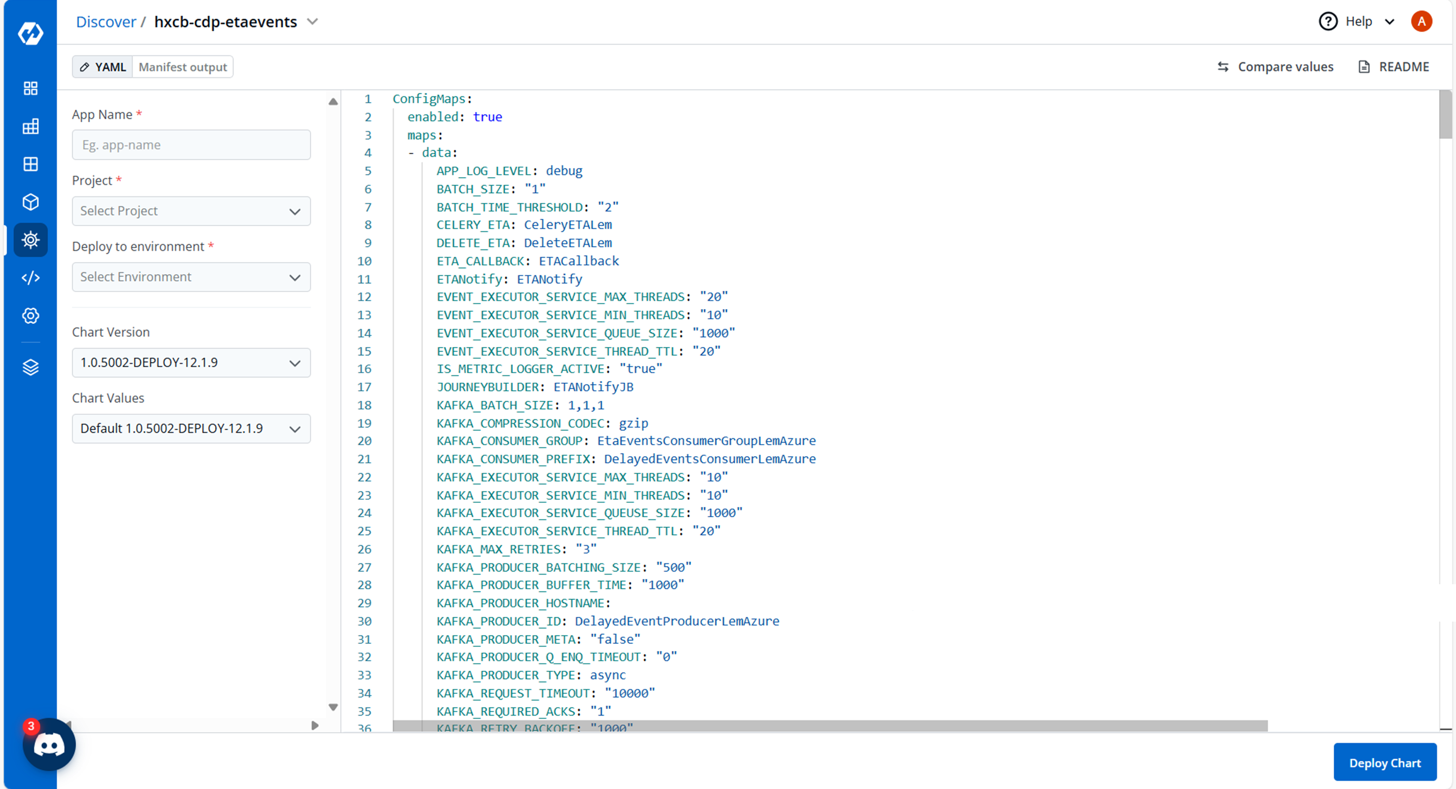

  3. In the YAML section, update the ConfigMap using the below details and deploy the chart.
    APP_LOG_LEVEL: debug
    ROOT_LOG_LEVEL: WARN
    LOG_LEVEL_UTILS: debug
    KAFKA_CONSUMER_GROUP: EtaEventsConsumerGroupLemAzure
    KAFKA_CONSUMER_PREFIX: DelayedEventsConsumerLemAzure
    KAFKA_TOPIC_LIST: CeleryETALem,DeleteETALem,ETACallback
    KAFKA_TOPIC_CONSUMERS: 3,3,3
    KAFKA_BATCH_SIZE: 1,1,1
    ETANotify: ETANotify
    TRIGGER: ETANotify
    JOURNEYBUILDER: ETANotifyJB
    TsdbEventsSent: TsdbEventsSent
    KAFKA_PRODUCER_META: "false"
    TsdbEventsRcvdMeanLatency: TsdbEventsRcvdMeanLatency
    TsdbEventsRcvdLatency: TsdbEventsRcvdLatency
    TsdbEventsRcvd: TsdbEventsRcvd
    KAFKA_EXECUTOR_SERVICE_MIN_THREADS: "10"
    KAFKA_EXECUTOR_SERVICE_MAX_THREADS: "10"
    KAFKA_EXECUTOR_SERVICE_THREAD_TTL: "20"
    KAFKA_EXECUTOR_SERVICE_QUEUSE_SIZE: "1000"
    BATCH_SIZE: "1"
    BATCH_TIME_THRESHOLD: "2"
    CELERY_ETA: CeleryETALem
    DELETE_ETA: DeleteETALem
    ETA_CALLBACK: ETACallback
    KAFKA_PRODUCER_ID: DelayedEventProducerLemAzure
    KAFKA_SERIALIZER_CLASS: kafka.serializer.StringEncoder
    KAFKA_REQUIRED_ACKS: "1"
    KAFKA_REQUEST_TIMEOUT: "10000"
    KAFKA_PRODUCER_TYPE: async
    KAFKA_COMPRESSION_CODEC: gzip
    KAFKA_MAX_RETRIES: "3"
    KAFKA_RETRY_BACKOFF: "1000"
    KAFKA_PRODUCER_BATCHING_SIZE: "500"
    KAFKA_PRODUCER_BUFFER_TIME: "1000"
    KAFKA_PRODUCER_Q_ENQ_TIMEOUT: "0"
    KAFKA_PRODUCER_HOSTNAME: b-1.hclswhsshxcbdevmsk.us1d78.c4.kafka.ap-south-1.amazonaws.com:9096,b-2.hclswhsshxcbdevmsk.us1d78.c4.kafka.ap-south-1.amazonaws.com:9096
    PRODUCER_BATCH_SIZE: "200"
    PRODUCER_BATCH_TIME_THRESHOLD: "2"
    PRODUCER_POOL_SIZE: "10"
    EVENT_EXECUTOR_SERVICE_MIN_THREADS: "10"
    EVENT_EXECUTOR_SERVICE_MAX_THREADS: "20"
    EVENT_EXECUTOR_SERVICE_THREAD_TTL: "20"
    EVENT_EXECUTOR_SERVICE_QUEUE_SIZE: "1000"
    REDIS_CONNECTION_TIMEOUT: "2000"
    TTL_MULTIPLIER: "1.2"
    IS_METRIC_LOGGER_ACTIVE: "true���

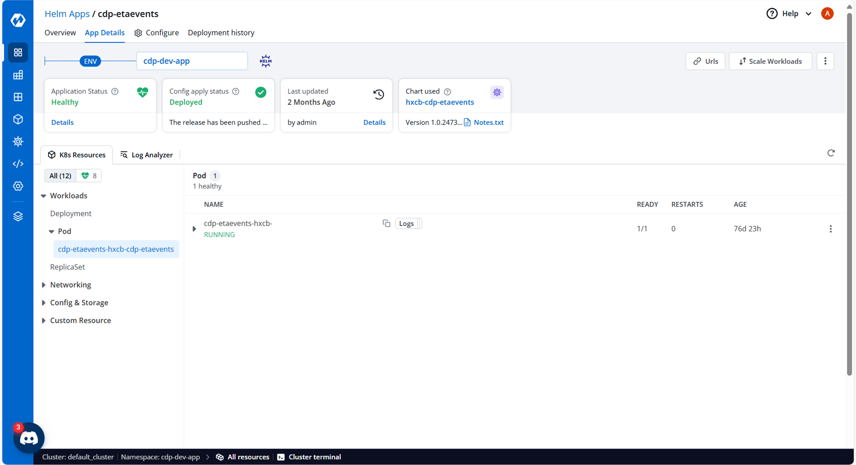

  4. On successful deployment, validate the deployment as shown below.
