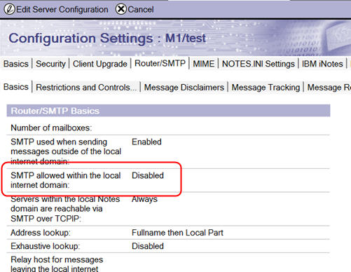

  6. Click the Router/SMTP - Basics tab and set the variable SMTP allowed within the local internet domain to Disabled:SMTP configuration setting
    Note: Servers in a Domino® domain where IMSO is used must have this variable set to Disabled - if this setting is enabled, it forces MIME messages to be routed over SMTP, which will affect the ability of Outlook users to read encrypted mail.

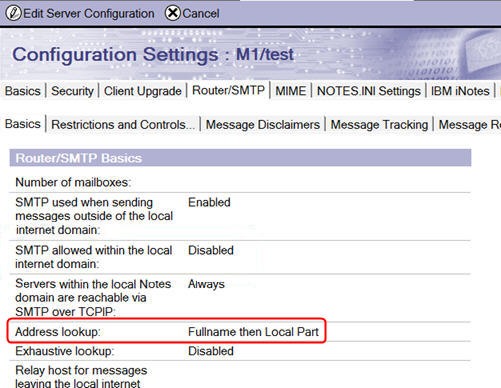

    Note: As a best practice, each person, group, and mail-in database should have an assigned internet address. Though not recommended or supported, you can set the variable Address lookup to Fullname then Local Part to work around this recommendation:Address lookup configuration setting
